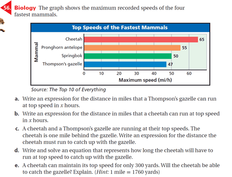

Toward the end of Middle School, I always knew it would come time for me to confront my algebraic innumeracy by means of rigorous and meticulous study of textbooks made available to me by friends who have taken Algebra 1 and Algebra 2 courses, to acquaint myself with what I need to know in order to take a set of courses that are math-intensive. I ask that you squelch whatever thoughts you have about me, a Grade 11 student who should be able to solve such problems without worry.
Below is the question that stultifies me, accompanied by my uneasy undertaking to solve it.
s = d/t, I imagine.
3. Attempt at a solution
a. I'm confident with my response to this one:
47x, 'x' being the number of hours the gazelle spent travelling: the totality of this expression upon the value of 'x' being discerned would represent distance travelled.
b. I'm confident with my response to this one, too:
65x, 'x' being the number of hours the cheetah spent travelling.
c. Here's where it gets tricky (for me). What I got was:
65x - 1
My reasoning, simple: it takes x hours for the cheetah to catch the gazelle. I don't exactly know how the -1 comes into play here (and not +1, considering he has to run another mile).
d. 65x = 47x + 1
[Subtract 47x from both sides]
18x = 1
x = 1/18
It would take 1/18 of an hour for the cheetah to catch up to the gazelle.
If we take what I initially suspected the answer to 'c' to be, we get a negative yielding, which is totally implausible:
65x + 1 = 47x
65x = 57x - 1
18x = -1
x = -1/18
Am I even on the right track?

This is wrong. The cheetah travels 65x miles in time x, while the gazelle travels 47x. As the cheetah approaches the gazelle, the gazelle will be going forward as well. This means that the cheetah won't run for 1/65 hours as you would expect. It will run more. Can you think how much it would run?
If the gazelle runs at 47 mi/hr and the cheetah runs at 65 mi/h, how fast is the distace between them closing?

Here is my second attempt. (HallsofIvy omits that there is a 1 mile disparity, and doesn't address my unease with representing this algebraically.)
The distance between them closes when the difference between the respective distances traveled is 0:
65*x - 47*x + 1 = 0
18*x + 1 = 0
18*x = -1
x = -1/18
In -1/18 of an hour, the cheetah will catch up to the gazelle.
Hardly a plausible answer.

That is the right approach. The rate of approach is 65-47 miles per hour. The distance between them is decreasing by 18 miles per hour. How far from each other are they at the start of part c. ? How much time would be required to close the distance to 0? Now, how far was this for the cheetah, using the actual fastest speed for the cheetah?

HallsofIvy did not omit anything; he simply left it up to you to do some of the work (as per Forum rules). Also: people cannot tell what makes you feel uneasy if you don't tell them!
RGV
Clue: The TIME is the same but the distances are different.
