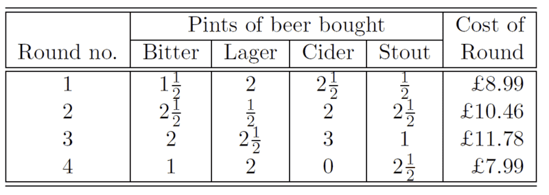

I came across the following problem somewhere on the web. The original site is long gone.
The problem has me stumped. May be sopmeone can provide some insight.
(The problem seems too simple to post in the "Linear/Abstract Algebra" forum.)
The Cost of Beer
It was nearing Easter, and a group of students went to a local pub for a (liquid) lunch. Unfortunately, only one of them had any money. But this student kindly offered to pay for them all on the condition that they refunded the money at a later time. During the course of this "lunch" four rounds were purchased, each consisting of combinations of bitter, lager, cider and stout. Due to an oversight the generous student made a record of who had drunk how much of each beer and what the total cost of each round was, but failed to make a record of how much a pint of each of the beers was! Fortunately the student knew all about solving simultaneous equations and realised that it was possible to calculate the cost of the beers from the information available.
The available data are summarised in the table below. (Without a mono-spaced font the table may be a bit out of alignment.)
Pints of beer bought:
Round Bitter Lager Cider Stout Cost of round
no.
1 3/2 2 5/2 1/2 8.99
2 5/2 1/2 2 5/2 10.46
3 2 5/2 3 1 11.78
4 1 2 0 5/2 7.99The student set the problem up in matrix form, denoting the costs of pints of bitter, lager, cider and stout as w, x, y and z respectively, giving a linear equation system.
The student was aware of the problems that could occur if the matrix was less than full rank, and checked that the determinant was indeed non-zero. Thus in full confidence the student proceeded to calculate the cost of each beer. The results were:
A pint of bitter cost: -3.86
A pint of lager cost: 0.60
A pint of cider cost: 4.58
A pint of stout cost: 4.26
The student was puzzled! On checking the calculations no errors were found! The charges made by the publican were also correct.
If nobody made any error why does it look like the students were being paid to drink bitter? What are the correct prices?
I verified the matrix calculation, and the costs for each drink are correct. As to why the results are as they are and what the correct prices should be, I have no idea.
Random ideas: every order includes a tip of some size. The half pints generate half penny prices which are rounded and messing up the linear algebra. The cost of a half pint is not half the cost of a full pint. All of these except the rounding issue don't lead to a solvable price though, and I would be surprised if rounding broke things this badly.

Yes, I have questions about the 1/2 pints. When they say that 5/2 pints were purchased is that 2 pints plus 1 half-pint? 1 pint plus 3 half-pints? I think the problem is under determined, with 8 variables; 4 types x 2 sizes.
Unless the problem is ill-conditioned, you can trust the linear algebra answer. There are no linear algebra police to guarantee that every problem is a realistic real-world problem. The negative cost of bitter is just because some of the totals are so low that there is no way to get there unless the cost of bitter is negative.
Yes. 5/2 pints = 2 pints + 1/2 pint.

Linear algebra should answer this problem, so if the result doesn't make sense then there's a mistake somewhere. Obvious options include half pints not costing half what a pint costs (very common) or some sort of price change (2-for-1 "happy hour"). I also note "coming up to Easter" in the problem description. The only possible drink related thing I can think of "coming up to Easter" is St Patrick's day, so pricing shenanigans on Guinness (a stout) are also possible.
If anybody wants to consider doubling a few prices or halving the numbers of stouts ordered, be my guest. I think the pint/half thing is hopeless unless someone knows a rule for how much more expensive two halves are than one pint.
DaveE said:
Just because we know linear algebra, doesn't mean it solves all problems.
It should solve this problem.
A thought of mine is that in a 4-dimensional space the solution should reside in the octant in which all x,y,z,w are positive (i.e. > 0). Is there some condition on the coefficient matrix that should guarantee this kind of solution?
Some numbers in the total cost column are too small. That forces a negative cost of something to get totals that small. The problem is not realistic.

Since the problem is non-linear (both from restriction of the domain to positive numbers and the rounding requirement), I don't see that there is a guarantee of an exact solution. I found some that were very close*, but not exact. I lost interest when I decided you needed 8 variables.
OTOH, you do have an exact linear solution. It's the one in the problem statement where they pay you to drink beer.
* $1.37, $1.46, $1.31, $1.48 per pint is one

Quite: that site is not suitable. Anyway the question is available on the interweb: it is the bonus question in Part 1 of worksheet 3 from http://www.staff.city.ac.uk/o.s.kerr/CompMaths/.
There is also a hint: the "correct" solution does indeed appear to depend on half a pint of beer priced at £1.99 a pint being £1.00.
Edit: a little trial and error should yield the correct solution quite quickly :smile:
This is not true: in the "correct" solution the prices are all realistic (if a bit cheap by current standards unless you drink in a popular chain beginning with "W").

I don't understand. I guess I am missing some important parts of the problem statement. I thought that the determinant was checked to be non-zero and there was a known solution to 4 equations with 4 unknowns. Is this a second solution?
I also do not see where there is anything nonlinear in the problem statement, and why people are talking about round-off issues.

OK, restrictions weren't literal in the problem statement. Except for the implication that the only (single) solution using linear algebra alone wasn't acceptable.
Still, if they are paying in Bitcoin, maybe there isn't a rounding restriction. IDK.
Yeah, the hint helps:

Then you will be surprised, although you shouldn't be: small errors in linear equations lead to big errors in solutions, and rounds 1 and 3 are pretty similar. I think this is a good question for illustrating that.
The only thing you are missing is the hint:
if the price of a pint of beer is £1.99, how much does half a pint cost?
And perhaps the fact that half pennies were removed from circulation in the UK in 1984 when beer was about 60p a pint.

The solution space is not continuous.

Exactly. We have 4 equations with 4 unknowns so if the unique solution is nonsense there must be something wrong with our equations.
The problem is ill-conditioned.
The costs in the original statement give the exact answer.
bitter=-$3.86; lager=$0.60; cider=$4.58; and stout=$4.26 gives these exact answers:
equ1=$8.99; equ2=$10.46; equ3=$11.78; equ4=$7.99
These costs: bitter=$1.37; lager=$1.46; cider=$1.31; and stout=$1.48 gives these close answers:
equ1=$8.99; equ2=$10.475; equ3=$11.80; equ4=$7.99;
The assumption that half a pint costs almost exactly half what a pint costs is false. If a pint costs £3, then a half pint could cost anything up to about £2, I suggest.

In that case, I suggest that this thread should not be in the linear algebra section. It should be moved to the "anything goes" section.

Yes, I suspect that is the point of the question - to show how small errors can dramatically affect the solution to an ill-conditioned problem. And as I said above you can easily spot the ill-conditioning - look at rounds 1 and 3.

You should not be looking for answers that are approximately correct to the initial set of equations, you need to look for answers are exact for a set of equations that is close to the initial set of equations.
For instance in round 4 cost £7.99 but if the price of stout was an odd number, say £1.49 then it would have contributed 75p to the round. If instead you use half the price of a pint then it would have contributed 74.5p and the round would have cost £7.985. This is the only other possibility for round 4 using the information in the question.

I don't think that would be legal in the UK, but in any case for the correct solution only 'normal' rounding is applied (i.e. half pennies are rounded upwards).

No the correct solution IS the exact solution to a set of linear equations, just not the set you think it is. This is to my mind a brilliant example of how errors can happen in the real world when choosing a model.

I'm going to have to play around with the rounding. I see how you're getting your answer but I'm unpleasantly surprised by how far off the linear solution is.

That's ill conditioning for you! But note again the linear solution is EXACT, it is the equations that are rounded.

No, the correct solution is the exact solution to a linear system which can be deduced from the information in the question.
