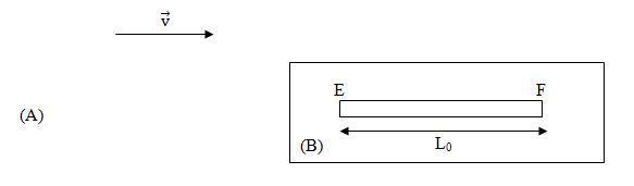

Hi, there is something I can't understand:
Consider a stationary observer at A. Now consider an observer B in a train that moves with constant velocity v with respect to A. In the train, B tries to measure the speed of light using an empty tube of length L0 (proper length as measured by B). He sends a light signal at extremity E, the signal reaches extremity F (where a mirror exists) and return back to the extremity E. B measure this duration T0 (proper period as measured by B).
Now B measure the speed of light as:
CB = 2L0/T0
Now according to A the length of the tube is contracted and the time is dilated, so he measure the speed of light as:
CA = 2L/T = (2L0/γ)/(γT0) = (L0/T0)/(γ^2) = CB/(γ^2)
which is different from the value measure by B (divided by Gamma squared)
What did I miss in this analysis?
thanks.

From A's frame the tube is moving. The light going from E to F does not merely travel a distance L0/γ since F moves while the light is in transit.

Let the time it takes for the light to go from E to F according to A be called T1. Then the distance traveled by the light must be (again, according to A):
cT1 = L0/γ + vT1
That's the length of the tube (in A's frame) plus the distance the tube has moved (in A's frame).
Do a similar analysis for the return trip.

From the stationary observer's perspective:
If T1 is the time of light travel in the same direction as the motion af the train, then
c*T1 = L/g +v*T1, which gives T1 = (L/g)/(c-v). Likewise, the time of light travel in the opposite direction is T2 = (L/g)/(c+v). Adding this gives, after a little algebra:
T1+T2 = 2gT, where T is the one way time measured by the moving observer, just as it should be. Thus, the assumption that the stationary observer measures the velocity to c leads to the right answer for the time.

The situation is as following:
A sees B moving at vrel, with a ruler/tube in front of him. At some point, an event happens. B shoots some photons towards the direction of the ruler/tube.
Both draw a coordinate system where they consider this event to happen at x=0/t=0.
As you correctly calculated, the time for the lightbeam to travel the ruler and back seen from B's point of view is 2Lo/cA will see the same ruler length contracted L = Lo*1/γ
So LOGICALLY, as light travels at c for both observers. If the ruler was not moving, it would be trivial 2L/c. Unfortunately the ruler end is moving away of the lightbeam, while the back is moving towards it on the turn around trip.
So we have L/(c-vrel) for the time it takes to move towards the end, while we have L/(c+v) for the time it takes to move back.
L/(c-vrel) + L/(c+vrel) is the time it takes seen from A's point of view.
Time-interval expansion(dilation) is measured LOCALLY in B's rest frame. Meaning that two events which happen at the SAME space but at different times and are measured to have a time interval of t seconds, are measured in A's rest frame to have a higher time-interval (dilation/expansion).
They do NOT happen at the same space-distance in A's frame.

The distance light will travel in A's frame is NOT 2L. You forgot that A sees the tube moving. This increases the distance on the trip towards the end, while shortening it on the round-trip.
L/(c-v) = t1 is the time the lightbeam takes to the end of the tube, seen from A's point of view
L/(c+v) = t2 the time it takes to the back.
Light travels at c. So we have a total length of c*t1 + c*t2 = Ltotal
So instead of just 2L/c you have,
Ltotal/c should be T as seen from A's point of view. I did not calculate it, so there might be some mistake if my mind tricked me.

Let t1 be the time from E to F, and t2 from F to E as measured by A.
According to Lorentz transformation:
t1 = γ(T0/2 + vL0/c2)
t2 = γ(T0/2 - vL0/c2)
d = (L0/γ + vt1) + (L0/γ - vt2)
= 2L0/γ + v(t2 - t2)
= 2L0/γ + v(2γvL0/c2)
= 2L0/γ + 2γL0v2/c2
= 2L0(1/γ + γv2/c2)
CA = d/t = 2L0(1/γ + γv2/c2)/γT0
= (2L0/T0)(1/γ2 + v2/c2)
= (2L0/T0)(1 - v2/c2 + v2/c2)
= (2L0/T0)(1)
= 2L0/T0
= CB
Thank you very much for your help, it was very difficult to me to solve it alone. Thank you very much.
