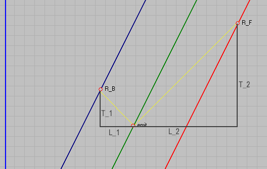

We have train and platform, with a light source in the middle of the train sending a beam to two receivers one at each end.
The diagram 'train-frame' shows this in coordinates in which the train is at rest (train coords). The blue worldline is someone on the platform receding at ##0.5c## (##\gamma=1.1547##). In the train frame the diagram is symmetric and the light beams hit the receivers at the same time on the three train clocks. The distance covered by the light is equal to the clock time that elapsed so ##c=1##.
The second diagram shows the scenario in the platform coordinates. It is no longer symmetric and the light beams do not hit the receivers at the same clock time. The distance traveled by the light has shrunk for the back receiver and grown for the front receiver. The corresponding clock times have shrunk/increased by the same factor so ##c=1## in these coordinates.
It is straightforward to show that the distances in the new coordinates ( L_1, L_2) are the Doppler shrunk/stretched lengths as measured in the train frame (these are acquired by radar distance measurement).
So - where is the contracted length or distance? All we need to balance the books is proper times and radar distances. The first is an invariant and the second is an operationally defined distance - not a fudged definition of distance.
'Contracted distance/length' exists only as a factor in a Lorentz transformation. It is not required in frame independent calculations. It is used an imaginary fudge-factor that helps get the right answer to a pointless calculation.

I've seen it. Thanks for the input. I have no problem with differential ageing. As Rindler says 'time dilation is cumulative' so it is easily verified.
I didn't want this thread to be a discussion about the physicality of 'length contraction' but ...
In the train scenario I used, if the train physically contracts from the POV of the platform won't the train clocks have been in motion relative to each other for a short time ? This would desynchronise those clocks wouldn't it ?

:oldconfused: Any measurement involving two separated clocks uses a simultaneity convention...
If you mean that all the train clocks must be showing the same time, then this is not true. We don't look at any clocks when we measure.
If you mean all the lab clocks must be running at the same rate, that is automatically true.
The integral ##\int_0^L dx## has no time in it, so we can measure the near end, have tea and then measure the far end and subtract.
No special tinkering with timings is required.The 'contracted length' is a geometrical construct made by projecting the train spatial slice into the platform spatial slice. We can work this out using the kinetic decomposition described for instance in Malaments book Topics in the Foundations of General Relativity and Newtonian Gravitation Theory (chaper 2.4). The spatial projection metric is
##h_{ab}= g_{ab}-u_a u_b ## which has ##h_{xx}=\gamma^2## which means that lengths in the x-direction differ by a factor ##\gamma##.
But we cannot call this 'contracted length' without a choice of simultaneity, which I hope will be revealed in the temporal projections.
Stay tuned.
People on train can measure one end of train, have a tea, and then measure other end. Let say they get result 100 meters.
We station people see that their result is 100m but we measure less because we must use concept of simultaneously because train is moving.
Of course we can also measure one end, have a tea, and then measure other end and then calculate (how much train moved when having tea) correct train length.
Or if we don't want to calculate, we just measure train length with simultaneous (which train people disagree) measurements. Both techniques gives us less than 100 meters.
Length contraction is not physical
Mentz114 said:
If you mean that all the train clocks must be showing the same time, then this is not true. We don't look at any clocks when we measure. If you mean all the lab clocks must be running at the same rate, that is automatically true. [..]
Neither. As remarked by me and 1977ub in preceding posts, it seems as if you privilege the system that you designate "rest system" in comparison to the one that you call "moving system". However, those systems are arbitrary inertial systems, and according to SR they are on equal footing. Both systems use the simultaneity convention that is discussed in §1 of http://fourmilab.ch/etexts/einstein/specrel/www/ . If I correctly understand your train example, it's a simple variant of Einstein's train example, using two clocks at a distance in the train and also two such clocks on the platform, and you designate each as "inertial frame" for measurements. Therefore I disagreed with your comment that"The only measurement that assumes no simultaneity convention is the one in the rest frame.". To the contrary: both frames assume the Poincare-Einstein simultaneity convention.
The integral ##\int_0^L dx## has no time in it, so we can measure the near end, have tea and then measure the far end and subtract. [...]
Once more: that is only true according to the perspective of the platform observer, and the train observer makes the same claim about the train.
Please explain the null result of a moving interferometer, assuming that SR's postulates are correct. :cool:
PS. note that no simultaneity convention is used in such measurements, which very much simplifies the analysis.
Suppose I have 1 meter square sheet of film, and flash bulb placed e.g. 100 meters above it. A 2 meter (rest length) ruler, moving parallel to the film plane in the direction of its length, and e.g. 1 cm above this plane, is approaching. I time the flash to fire such its light will reach the film when the center of the ruler is above the center of the film. The ruler is moving at .968 c. What I get is an image on the film of a ruler shadow 1/2 meter long. What is your (Mentz114) philosophy for treating this as 'not physical'? No coordinates or conventions are involved. Just a few objects at mutual rest, and another object moving relative to those.
