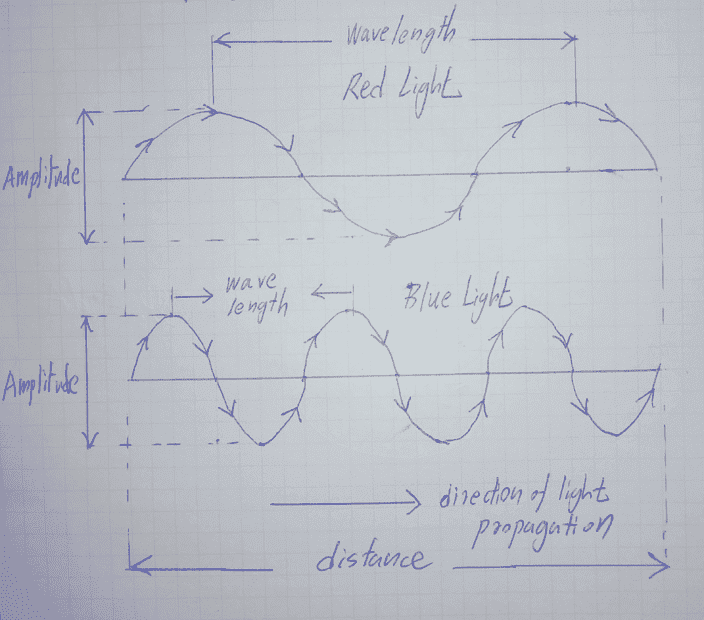

louis_slicka
We know the speed of light is a constant but speed is just the measure of distance over time. If blue light has a shorter wavelength than red but covers the same distance / time does this mean that blue light has actually made a longer journey than red light in order to arrive simultaneously?
I Imagine two roads that start and finish at the same point. A 5 mile straight road and a 10 mile bending road . A car will have to travel twice as fast on the winding road in order to finish at the same time
No.
That's true, but a car on a winding country road is a poor analogy for an electromagnetic wave.
The fact that blue light is a shorter wavelength doesn't mean it traveled a longer journey, any more than a compact car has to travel further than a limousine on a straight road.
Your winding road analogy is poor, the distance traveled by light is independent of the transverse motion. Light doesn't move like a slithering snake.
Compare it more to a car on a straight road with two kids in the back seat - on of them high on sugar.
Sugar kid bops around twice as fast, but that doesn't mean he literally travels a path twice as long and twice as fast.
I am just guessing here at the reason for your expectation.
We often see light depicted in science videos or in textbooks as a sort of sine wave. For instance (picking a Google hit at random). https://physicsopenlab.org/2019/08/20/polarization-of-light/
It is easy to imagine that this means that the light is actually following the wavy path instead of propagating along a straight line. That imagination is dead wrong.
Depictions of light as a sine wave along the x-axis are using the x to measure distance. But they are using the y and z axes to depict transverse electric field strength, not transverse displacement. The light wave propagates in a straight line regardless of frequency.

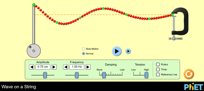

A better picture of a wave is a beaded string.
From https://phet.colorado.edu/sims/html/wave-on-a-string/latest/wave-on-a-string_en.html
A bead along the string moves up and down ("transversely"). It does not travel down the string.
(For a longitudinal wave, the oscillation is along the direction of motion. However, the bead oscillates around the same center point of the string and does not travel far along the string.)
For light, the "Electric Field at that point" plays the role of the "transversally displaced bead".
What does travel down the string is the "disturbance" of that bead from its equilibrium position.
A bead further down the string will have the disturbance of its upward-neighbor.
The frequency of the oscillation of one bead (or of light at a point in space)
is different from the speed of propagation of the wave along the string.
They are related by the "wavelength" (marking the regular spacing of the disturbance-pattern in space).
Blue light has a shorter wavelength than red light.
Blue light has a higher frequency (shorter wave period) than red light.
However, the wave speed of light in vacuum is the same for both blue and red light.
Do you think that light will travel along the curved path of a sine wave, so under the same propagation distance, blue light will actually travel a longer distance than red light?
I think this is a misunderstanding. Light is a transverse wave. The amplitude of the sine wave only represents the amplitude of light. Light does not really travel along the curved path of a sine wave.
I think the arrows in this diagram contribute to the misconception in the OP.
(There is no "winding road", as envisioned by the OP.)
That's why I think the "beaded string" I mentioned in the previous post is better in conveying
that it is
the disturbance of the bead at a point P--but not the bead itself---is what propagates along the axis.

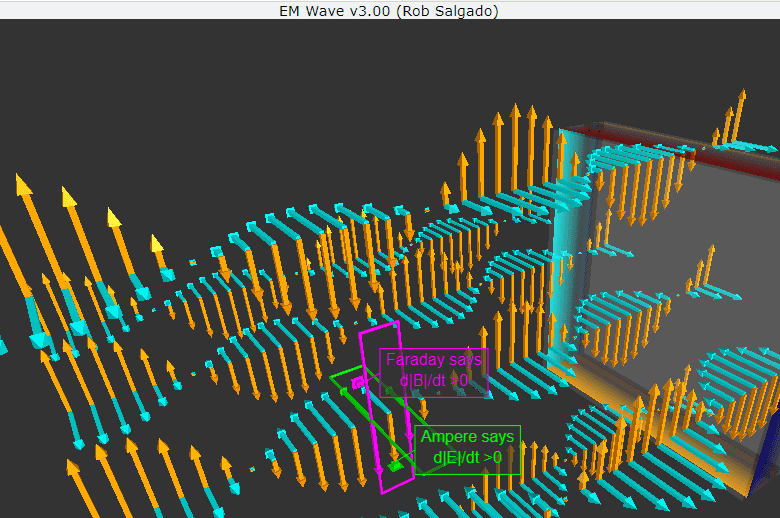

Here is my visualization of an electromagnetic wave using Glowscript
https://trinket.io/library/trinkets/216f415a46
