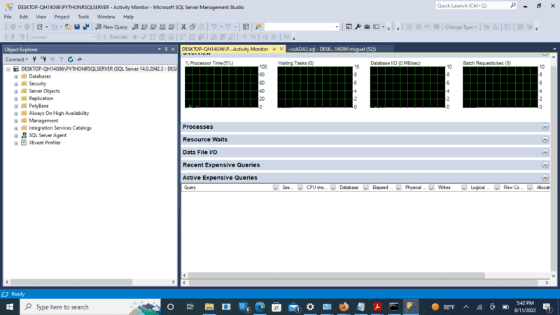

Have you tried doing a trace (Profiler, IIRC) ? Maybe translating to Relational Algebra?Execution Plan
Activity Monitor?
Thanks,
Have not messed with profiler
