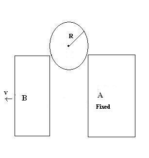

Sphere slipping against blocks
In the given arrangement ,a sphere of radius R is placed on the two blocks A and B where A is fixed and B is moving at a constant speed ‘v’ towards left .Find the speed of the sphere’s center when the distance between the blocks is √R and the sphere’s center is at a vertical distance √R from the top of the blocks .All surfaces are frictionless .
Ans : v/2
Let the distance between the blocks be 'y' at any instant.
Let the distance between the sphere’s center be at a vertical distance 'x' from the top of the blocks .
Let the horizontal distance between B and sphere's center O be 'l' .
Then l=y/2 .
Differentiating we get,dl/dt = (1/2)dy/dt = v/2
From the geometry of the setup , x2 + l2 = R2
Differentiating , we get dx/dt = -(l/x)dl/dt .
Now when x=√R and y=√R (i.e l=√R/2) ,we have dx/dt = -v/4 i.e the horizontal speed of O is v/4 downwards .
The center also has a horizontal speed v/2 towards left.
The net speed of the center is (√5/4)v which is incorrect .
I would be grateful if someone could help me with the problem .

Hmmm, maybe I'm not understanding the problem correctly, but the geometry for this problem seems to be over-constrained.
From the problem statement:
  • The distance from the center of the sphere to the contact point on block B (or A for that matter) is (√R)/2. We'll call this B.
  • The distance from the center of the sphere to the top of the blocks is √R. We'll call this C.
  • This distance from the contact point on block B to the center of the sphere is the radius R. We'll call this A.
These three constraints form a right triangle, and the Pythagorean theorem tells us that A = √(B^2+C^2). Plugging the above in gives us:
R = √(((√R)/2)^2+(√R)^2) = √((R/4)+√(R)) = (√5/4)R
This shows that the given dimensions cannot result in a right triangle, suggesting an ill-defined problem.
Hello, Tanya.
I'm wondering if there's a mistake in the wording of the problem. It doesn't seem dimensionally correct to take the distance between the blocks to be √R. Anyway, if you let x = √R and l = (√R)/2, then you certainly wouldn't satisfy x2 + l2 = R2.
[EDIT: Incorrect statement deleted.]
I tried working backwards from the v/2 answer to figure out the misprint. I deduced that the blocks are touching! And if you think about that arrangement you can see it does indeed give v/2. The centre of the sphere will be moving left at half the speed of the block.
Before I did that, I would have guessed it was supposed to be a separation of R√2, with the sphere's centre initially R/√2 above the blocks. That gives a speed of v/√2. Could this be a record for misprints in one question?
Tanya, to get some benefit from the question, try taking the separation to be some unknown x and post what you get.
Hi TSny…
It seems the new year hasn’t started well as far as putting up a question on PF is concerned.I regret putting up an ill defined problem :redface:.
Anyways I feel I have figured out the problem with the problem .Interestingly,all the radical signs have gone topsy turvy .
Here is what I believe the question should have been :
"In the given arrangement ,a sphere of radius R is placed on the two blocks A and B where A is fixed and B is moving at a constant speed ‘v’ towards left .Find the speed of the sphere’s center when the distance between the blocks is √2R and the sphere’s center is at a vertical distance R/√2 from the top of the blocks .All surfaces are frictionless .
Ans:v/√2 "
What is your opinion ?
I feel the same .
Yes... But this record has left me :redface:.
Tanya Sharma said:
Hi TSny…
Ans:v/√2 "
I like it. It's the same as haruspex's prognosis!
Thanks TSny...
Actually I figured out the problem with the problem the moment I saw the initial response .But found it quite hard to believe that the question had so many mistakes .I even responded just after you have replied , only to delete the post .
