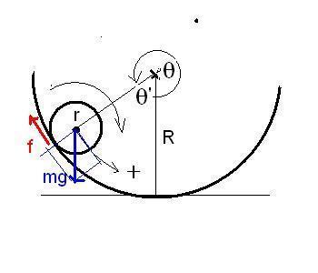

See picture.
The CM moves anticlockwise, Ω=dθ/dt is positive.
Edit: Theta must be the angle indicated in the picture. The correct equation is [tex](R-r)\ddot\theta = mgsin(\theta')-f[/tex]
instead of
[tex](R-r)\ddot\theta = mgsin(\theta)-f[/tex]
the friction means a negative torque (rotates the ball clockwise) The angular velocity of the rotation is ω.
[tex]\dot\omega = -fr/I[/tex]
No slip condition: (R-r)Ω+rω=0--> [tex]\dot\omega = -\ddot \theta (R-r)/r[/tex]

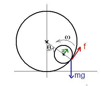

Well, I succeeded to confuse myself as I drew the ball at negative angle... Now I try to define the positive direction for everything.
So the ball is at positive θ initially. The acceleration is positive if it is up and to the right. The tangential component of gravity acts downward and to the left, so θ will decrease. Without friction, the ball would slide to the left, so static friction acts to the right and up. The static friction yields positive torque with respect to the CM.
ma=f-mgsinθ. a=(R-r)d2θ/dt2
rf=Idω/dt
No-slip condition: v(CM)+rω=0-->dω/dt=-(R-r)/r d2θ/dt2
I hope that is correct now.
ehild
  • Diagram of a small ball of radius r rolling inside a larger circle of radius R, with center marked and angle θ from the vertical, angular velocity ω, friction f, and gravity mg labeled.

The acceleration will always be directed towards the bottommost point of the surface that is equilibrium position .So whether the sphere is rolling upwards towards right from mean position or rolling downwards towards mean position ,the sign of a in equation for translation motion should always be negative i.e f-mgsinθ = -ma . Am I right or wrong ?
It was the definition of positive directions. I took the acceleration positive if the CM moved anticlockwise. That means, the acceleration has negative value when the ball rolls towards the equilibrium point from that position.
The same as in a Cartesian system of coordinates: you set the x-axis horizontal, positive direction pointing to the right. Then a particle to the right from the origin and moving towards the origin has positive x coordinate and negative velocity v=dx/dt as x decreases during the motion.
You have to define the positive direction both for the angle θ and the acceleration once. The ball oscillates about the equilibrium point. Once it is to the left once it is to the right, but it always accelerates towards the equilibrium. Imagine an SHM along the x-axis around the origin. Once the particle is to the right, once it is to the left from the origin, but always accelerates toward the origin. Do you consider the acceleration always negative?
You can define the positive direction for a anyway, but take care when relating it to the second derivative of the angle θ. If you count the angle anticlockwise from the vertical, V(CM)=-(R-r)dθ/dt, as the angle decreases when the sphere moves to the left, and the acceleration is a=-(R-r)d2θ/dt2.

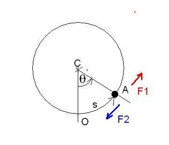

Consider a simple circular motion like in the figure. Instead of a linear coordinate x, you give the position of the point along the circle either with arc length s between O and A, or with the angle θ, measured from CO anticlockwise. Note that s and θ serve as coordinates now, both can be either positive and negative.
When the point changes position, the angular displacement is positive if θ increased. The angular velocity is defined as ω=dθ/dt.
ω is positive if θ increases and negative when θ decreases. So the direction of the angular velocity is defined with respect to the anti-clockwise direction.
The linear velocity along the arc of circle is defined as v=rω. Again, it is positive if the point moves in the positive direction (anticlockwise) and negative when it moves to the opposite direction.
The same with the accelerations. The angular acceleration is β=d2θ/dt2, the linear acceleration along the arc is a=rβ.
When some force F acts at a point tangent to the circle, it counts positive if its direction is the same as the positive direction along the circle. So F1 causes positive acceleration and F2 causes negative one. But ma=F holds for both forces.
If the magnitude of F1is f, and the magnitude of F2 is mgsinθ, Newton II reads as ma=-mgsinθ+f.
ehild
