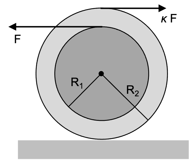

Hi, I started this thread to address the solution of this problem.
Problem
A yo-yo of radii ##R_1=R## and ##R_2=\frac{7}{5}R## is acted upon by forces ##F## and ##\kappa F~~~(0<\kappa<\infty)## as shown in the figure on the right. The yo-yo rolls without slipping on the horizontal surface. The mass of the yo-yo is ##M## and its moment of inertia about its center of mass is ##I=qMR_2^2##.
Given quantities are ##R##, ##F##, ##\kappa##, ##M## and ##q##.
(a) Find the linear acceleration of the center of mass of the yo-yo in terms of the given quantities.
(b) Find the force of static friction acting on the yo-yo in terms of the given quantities.
(c) Find the value of κ such that the yo-yo rolls at constant velocity.
(d) Find the value of κ such that the force of static friction is zero.
(The ratio R2/R1 is given a numerical value to match the drawing to scale)
My attempt
Let's take the yo-yo as the "system". Vertically acting forces balance out, so they aren't part of the problem.
a) to calculate the yo-yo CoM's linear acceleration w.r.t. horizontal plane rest frame, one can proceed as follows: at any given time ##t##, going in the (inertial) system's CoM momentarily comoving reference frame, conservation of angular momentum gives: $$I\dot \omega = FR_1 + R_2(f_s - \kappa F)$$ From rolling without slipping condition ##v_{cm} = R_2 \omega## follows ##\dot v_{cm} = R_2 \dot \omega##.
Furthermore in the horizontal plane's rest frame: $$MR_2 \dot \omega = F(1 - \kappa) - f_s$$
Solving the above linear system for ##\dot \omega## $$\dot \omega = \frac {5F (12 - 14 \kappa)} {49MR(1 + q)}$$ hence $$\dot v_{cm} = \frac {F(12 - 14 \kappa)} {7M (1+q)}$$
b) solving the system for ##f_s## gives: $$f_s = \frac {F[7(1+q)(1- \kappa) -12 + 14 \kappa]} {7 (1+q)}$$
c) rolling without slipping at constant system's CoM velocity means ##\dot v_{cm} = \dot \omega = 0## hence $$\kappa = \frac {6} {7}$$ d) From b) setting ##f_s=0## one gets: $$\kappa = \frac {5 - 7q} {7(1-q)}$$
You are assuming here that the sign convention on ##f_s## for ground on yoyo is positive to the right. That is fine, but it would have been good to state it explicitly. You are also adopting a sign convention that rotation is counter-clockwise positive.
You are clear on your frame of reference and I agree with the formula. We are off to a good start.
You have a sign convention here so that ##v_\text{cm}## is positive to the left. Opposite to the convention for ##f_s##. No problem as long as we keep our conventions straight.
And there it is. Horizontal momentum conservation. With a minus sign on ##f_s## due to the sign convention.
The set up looks good. The rest is algebra. My eyes are glazing over at this point. I am too lazy to check the algebra.
Good job.
Edit: And then the algebra turned out to be wrong. :-(
If ##\kappa = 0## can we tell which way ##f_s## is pointing?
From b) we get for ##\kappa = 0## $$f_s = \frac {F[7(1+q) -12]} {7 (1+q)}$$
Which gives the expression:
$$ F \left( 1- \frac{12}{7(1+q)} \right) $$
Test some values for ##q##. For instance ##q = \frac{1}{2}##. Can ##q## be larger than ##\frac{1}{2}##, smaller?

A.T. said:
Consider how it would slip without friction:
- With small relative moment of inertia the yo-yo will rotate too fast for its translation
- With large relative moment of inertia the yo-yo will translate too fast for its rotation
The slip would be in opposite directions, thus is the static friction which prevents it.

erobz said:
The equations say it flips direction somewhere before ##q= 1##.
Yes, and R1/R2 < 1. So where is the problem?
I ask again...explain. You are telling me "static friction" it is going to definitely flip at a specific ##q## regardless of the materials I have selected and the force ##F## that is acting...Oh and all of this is due to the very suspicious introduction of some "slipping criteria" into the problem.
I'm pulling it with a little tiny force ##F## - we aren't jerking it or anything like that in the very precise region around the special ##q##, that I will calculate if you desire. The friction goes one way. Then I change out the wheel with a tiny incremental change in size...suddenly, I'm to believe the friction acts the other way...How ever could we explain this clearly fundamental constant ##q_{switch}## of nature.
I can't see it...should I just say, there is nothing suspect about that at all! Move along, "the Radi have a ratio less than 1...nothing to see here!"
Why suddenly? If you vary q smoothly, then fs will smoothly pass through 0.
You cant vary ##q## smoothly. It is a fixed property of the wheel.
Then what do you mean by fs suddenly changing direction? If q is fixed then so is the fs direction.
I have a wheel its ##q## value is just less than ##\frac{5}{7}##. I'm applying ##F##. The wheel rolls without slipping. The calculations indicate the friction point to the left( or right), then I make a small incremental change to ##q## such that its now greater that ##\frac{5}{7}## and repeat the experiment, the calculation tells me the friction force now points to the right (or left). I've changed nothing else. The wheel still goes in the direction I pull it in both cases. One case has a friction force pointing right, the other left!
Yes, and?
A.T. said:
Yes, and?
and its absurd.
erobz said:
and its absurd.
Why?
