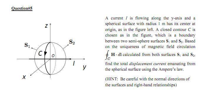

A current I is flowing along the y-axis and a
spherical surface with radius 1 m has its center at
origin, as in the figure left. A closed contour C is
chosen as in the figure, which is a boundary
between two semi-sphere surfaces S1 and S2. Based
on the uniqueness of magnetic field circulation (Closed line integral of)
H dot dl calculated from both surfaces S1 and S2,
find the total displacement current emanating from
the spherical surface using the Ampere’s law.
No idea
Not even sure where to start because it isn't clear whether these are conductive spheres or dielectric spheres. Once I figure that out, I could use the boundary conditions somehow... I honestly have no idea how to start this problem.
  • Diagram of a sphere centred at the origin with a current I along the y-axis, a closed contour C on the sphere's surface separating hemispheres S1 and S2, and the x, y, z axes labelled, next to the problem text.
Well, maybe I can at least give you an idea or two.
First, current i must be time-varying, or nothing happens electric-field-wise.
Second: using Ampere, write an expression for B around the wire, including the space defined by the two hemispheres. BTW the hemispheres are just geometrically descriptive surfaces. They have no material meaning. Least that's what I assume.
Third: now you have B(x,y,z). What is the Maxwell relation that relates E to B?
Fourth: what is the relation between E and D? Assume non-conducting medium.
Fifth: What is the meaning of "displacement current emanating from the spherical surface", given D and the surfaces? Think of an analogy with how you get from conduction current density J to conduction current in the Maxwell relation relating B to J and D.
Sixth: how can you apply Stokes' theorem in conjunction with item 3 to calculate item five?
No guarantees her, maybe you'll discover something along the way I didn't.
