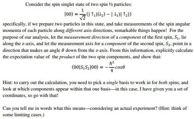

Typed problem text on the spin singlet state of two spin-1/2 particles: |00> = (1/sqrt2)(|up>|down> - |down>|up>), with an expectation value <00|S1S2|00> = -(hbar^2/4)cos(theta) to show and a hint about choosing a single basis.

I am just trying to figure out how to start the problem. Any help would be greatly appreciated.
Start by writing S1 and S2 in terms of the pauli matrices.
Would S1=Sz and S2 have cos(θ) instead of 1's in the matrix?
Yes, but you need to be careful about the sign, whether it is cos(θ) or -cos(θ), since the question says -"makes an angle θ down with the z axis".
Ok, but what does the question mean by picking a single basis to work in? I just don't know what the question is saying.
I believe they are trying to tell you to have both S_1 and S_2 in the same basis, i.e, either choose S_1 to lie along z-axis and S_2 to lie theta away from it, or choose S_2 to lie along z-axis and S_1 to lie -theta away from it.
Since they already chose the first of these options, the hint is redundant (as the author say so themselves!).
may be it will be clear if I show some solution,
Using the notation of question and I use + for up and - for down,
<00|S1S2|00>=-h-/2.h-/2 cosθ.(1/2)(<+-|+->+<-+|-+>),other two terms in brackets which you get are zero because of orthogonality condition.(The extra minus sign in front is just because cos(1800-θ)=-cosθ) and you will get this
=-h-2/4.cosθ(because <+-|+->=1 and similarly for other)
