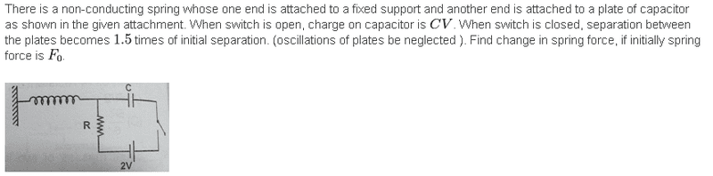

Force of attraction between the plates = (1/2)(QV)/d
Initial charge on the capacitor Q1=CV
Final charge on the capacitor Q2=2CV
When switch is open force between the plates F1 = (1/2)(Q1V)/d1 = (1/2)(CV2)/d1
When switch is closed force between the plates F2 = (1/2)(Q2V)/d2 = (1/2)(2CV2)/d2
d2 = (3/2)d1
F1/F2 = 3/4 or F2 = (4/3)F1
The spring force also becomes 4/3 times of the initial force i.e (4/3)F0
Is it correct ?
Many Thanks
Be careful here, the capacitance changes.
The potential changes as well, which influences the calculation of F2.
:sorry:
F1/F2 = 8/9 or F2 = (9/8)F1
The spring force also becomes 9/8 times of the initial force i.e (9/8)F0
Is it correct now?
Can you show your steps? I get a different result.
Sorry once again .
It should be (16/9)F0 .
If it is wrong , i will surely show you the steps :smile: .
That agrees with the answer I got.
Thanks mfb .
The spring stretches in both the situations . More in the latter case , as attractive force between the plates gets stronger.
Right ?
Right. Which also means the system has to be moved a bit, otherwise the solution doesn't make sense.
