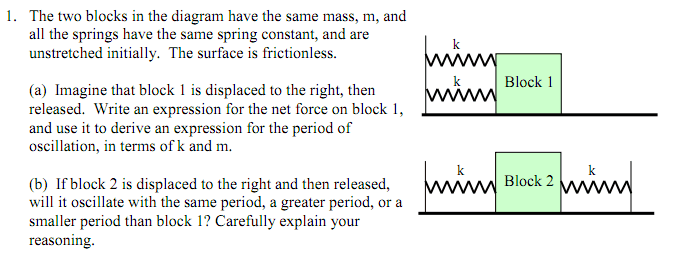

Here is the question:
I know that SHM is: accel = -(constant) (displacement)
Linear from my book says: Ax = Ftotal/m (dont quite get this)
Any help? THanks!

I need to be able to write an expression for the net force on block 1, and use it to derive an expression for the period of oscilation, in terms of k and m
In each case I think the force on the block is 2kx (x is the displacement)
I would use this to write an expression for the acceleration (= F/m)
then acc =ω^2x to get an expression for ω^2 then get the time period expression.
get back to me if you cannot do this

Ok FIRST for a) Write an expression for the net force on block 1 - Let's start with this ok?
Would it not be just: 2kx --- is that correct? Its because there is 2 spring constants.
---->NOW if that is right, let's move onto " Use it to derive an expression for the period of oscillation, in terms of k and m"
I don't know how to get this...?
So if the force = 2kx then acceleration = F/m = 2kx/m
Acceleration = ω^2 x
so ω^2 = 2k/m
Can you get an expression for frequency or time period from this?
ask if you are not sure... but you know the 'rules' of this place... I prefer not to give you the answer directly... you are almost there.

K wait... acceleration is 2kx/m
Where did "Acceleration = w^2x, so w^2 = 2k/m come from? Can you explain this to me?
Umm: Period = 2pi sqrt(m/2k)
Is that what you mean?
and the frequency would be 1/Period
No problem... be patient
SHM is when F is proportional to displacement,x,
that means F = kx... should be F = -kx because displacement is a vector but forget that for now
This means that F = ma = kx so a = kx/m... looks better like this ... (k/m)x
By analysing SHM and its links with circular motion you get a = ω^2 x, so ω^2 = k/m
In this problem, because there are 2 springs k = 2k
so ω^2 = 2k/m... are you OK now?
I will explain in more detail if you do not get it ! Don't panic ... it is tricky
you have got it:approve:
well done

Oh cool. So,
This answers a) completely?
I think so
it would be good to have confirmation from another contribution but I am happy with my answer
