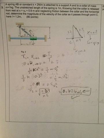

A spring AB or constant k = 2N/m is attached to a support A and to a collar of mass
m=1kg. The unstretched length of the spring is 1m, Knowing that the collar is released
from rest at x = x0 = 0.9 m and neglecting friction between the collar and the horizontal
rod, determine the magnitude of the velocity of the collar as it passes through point C.
here l = 1.2m,
T1 + U1-2 = T2
T Kinetic Energy
U Potential Energy
I just wanted to see if the answer is right ??
Handwritten solution to a spring and collar energy problem: energy equation T1 + U1-2 = T2, then 1/2 k x^2 = 1/2 m v^2 with values, yielding v2 = sqrt(0.09/0.5) = 0.424 m/s, beside a small right-triangle geometry sketch and a diagram of a collar on a horizontal rod attached to spring AB.
I don't think you handled the work done by the spring correctly. It is not k(.3)2/2.
I don't see it... I thought he was correct noting the length of the spring changes from 1.5m to 1.2m.
x22-x12 ≠ (x2-x1)2
