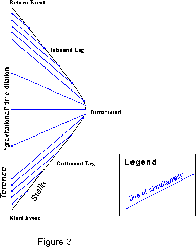

I don't agree. Two observers that simultaneously attain a constant and equal proper acceleration from a rest frame and are separated by the distance of the Rindler horizon according to the leading observer
First of all, observers at different positions in Rindler coordinates don't have equal proper acceleration, the ones closer to the Rindler horizon must have greater proper acceleration (the observers are undergoing what is known as Born rigid acceleration, which means that the distance between them stays constant in their instantaneous inertial rest frame at each moment, and the math works out so that this can only happen if the trailing observer has a greater proper acceleration). Second, if the leading observer saw the trailing observer at the Rindler horizon at some moment, the trailing observer couldn't stay on the Rindler horizon since that horizon is expanding outward at the speed of light as defined by any inertial frame. Again, look at the second diagram from the Rindler horizon page I linked to:
This diagram is drawn from the perspective of an inertial frame. The curved lines represent observers with constant position in Rindler coordinates, and the dotted line is the Rindler horizon. You can see that the Rindler horizon is moving outward at c, and that observers closer to the horizon increase their speed more quickly (the tangent to each curve is vertical at t=0 in the inertial frame, so they are all instantaneously at rest at that moment, and you can see that the slopes of worldlines closer to the dotted line become closer to diagonal more quickly)

Okay, well if one messes with the distance coordinization in order to make the ticking working out the same in the reality of the non-inertial observer, then sure, but then one would have to design a different coordinate system for accelerating away from the rest frame as accelerating back, otherwise how would something like the twin paradox work out? In any case, I am only considering inertial observers with each having the same coordinate system to keep things simple.
Right, I editted my post since my last reply, sorry. The trailing observer having a greater acceleration must be what I was thinking. Anyway, I can now see that what is occurring with the light catching up to the accelerating observer can all be worked out from the frame of an inertial observer as you said.
And you understand how in Rindler coordinates, any given clock in that family of accelerating clocks can be ticking at a constant rate relative to coordinate time, and occupying a fixed coordinate position?

Right. We can have the trailing observer with a greater acceleration that remains a constant distance behind according to the leading accelerating observer so with zero relative speed and the clocks tick at the same rate according to the leading observer also.
My only quibble is that it's not really "according to the leading observer", it's according to Rindler coordinates (which the leading observer doesn't necessarily have to use if he doesn't want to, even if he's restricting his attention to coordinate systems where he's at rest).
