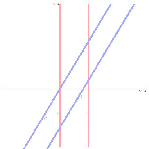

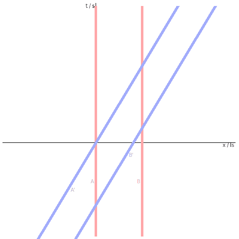

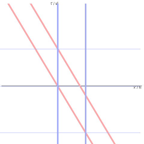

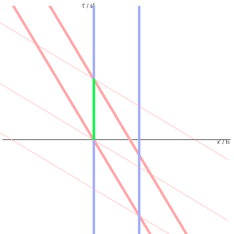

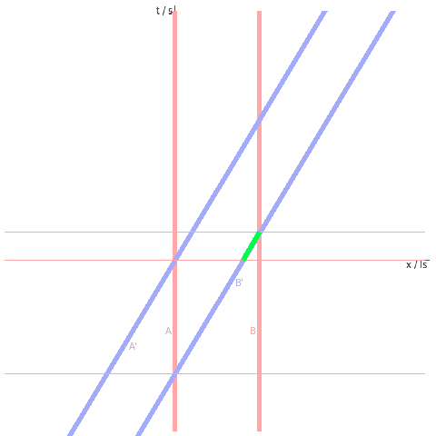

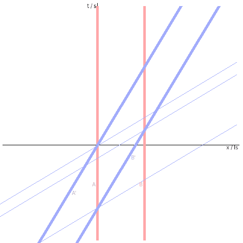

Leepappas said:
There are two moments in time or states of the universe that I am focusing on.
No, there are four states. Thinking that there are only two is your underlying problem. The details of the correct analysis are in Peter's post.
Peter did the analysis correct but his interpretation of what I was doing was incorrect. Furthermore he only used the three states State one state two and state three he didn't use four. Where is this fourth state that you're concerned with I don't see it.
  • Skeptical

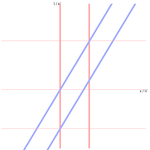

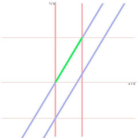

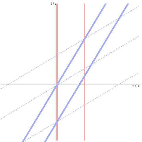

As I said, your two diagrams labelled "State 1" are two different states, as are your two diagrams labelled "State 3". That's four states.
I have something to do right now, but I can probably post a Minkowski diagram in an hour or so which will show you what I mean. In the meantime, why don't you go and google "relativity of simultaneity" and see if you can work out why your two states 1 and two states 3 are different.

Leepappas said:
I understand the Crux of your argument is that there are two states labeled State One, but there is only one initial state when B prime coincides with A at t=t'=0. How can there be two initial States when there is only one. It merely looks different from the two different frames but it's still just one state. I can wait an hour for your response.
This is a Minkowski diagram showing the worldlines of the front and rear of each of your two rods. Stripped of jargon, this is a simple displacement-vs-time graph that you should have encountered at school, except that time is drawn up the page and displacement across the page by convention.
This is drawn in your unprimed frame. The two reddish lines represent the front and rear of the stationary rod and the blue lines represent the front and rear of the rod moving to the right. Due to length contraction, this blue rod appear slightly shorter in this frame. Now let's mark on the times of your State 1, 2 and 3 diagrams in this frame with fine red lines:
So far so good, I hope. The first three diagrams in your OP can be generated just by taking horizontal slices through the diagram along the three fine lines.
Now here's where you went wrong. The Lorentz transform for time says that ##t'=\gamma(t−\frac{v}{c^2}x)##, which we can rearrange to ##t=\frac1\gamma t'+\frac{v}{c^2}x##. That means that a line of fixed time in the primed frame (##t'=\mathrm{const}##) is not a horizontal line in this frame. Let's draw the three lines of fixed ##t'## through the three key events as fine blue lines:
The second set of diagrams you labelled "State 1" and "State 3" can be drawn by taking sections along those blue lines (an scaling down by a factor of ##\gamma## because you can't draw a Minkowski geometry completely faithfully on a Euclidean plane). Note that they are not the same as the reddish lines! That's what I mean about there being four states here - the two you drew by looking along the top and bottom horizontal lines, and the two you drew along the top and bottom diagonal lines.
What are the implications of that? Well, first, let's draw that last diagram in the primed frame:
Hopefully you can see that this is a mirror image of the second image, because this time it's the red rod that is moving and length contracted. Hopefully that makes sense. Now let's go back to the unprimed frame and add one green line:
The vertical distance between the middle and upper lines is what you called ##\Delta t_2##. The green line marks the time interval ##\Delta t_2/\gamma##, which is the time ticked off by a clock attached to the left hand end of the blue rod in what the unprimed frame calls that same time interval. But now look at it when it's transformed into the primed frame:
It is not the time interval between the right hand end of the red rod meeting the right and left ends of the blue rod. And your "proof" relies on the assumption that it is, if I read your mess of badly typeset maths correctly (we have ##\LaTeX## enabled on the forum for a reason).
As has been said several times already, you did not account for the relativity of simultaneity.
I followed you and agree up to the point where you say now here's where you went wrong. Then for some reason you assumed that t prime is a constant, when it's clearly not.
## t' = \gamma (t- \frac{vx}{c^2})##
It's a constant across space at one instant of time. Each of your diagrams is drawn at one instant of time is it not?
Yes I reread it now I understand what he did.
In the second dstance versus time graph the horizontal line representing state three is drawn too high. It should intersect the lower Blue line where the lower Blue line intersects the rightmost vertical Red line. That's the moment B prime coincides with B. The way you have state three drawn is the moment when A prime coincides with B.
