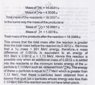

I am thankful that the replies have helped me clarify many of my misconceptions. I have one more doubt in mind in support of my statement made earlier regarding breaking of nucleus. In Rutherford nuclear reaction where nitrogen is hit by alpha particles and oxygen and a proton are produced, there is about 1.13 MeV energy required to be possessed by the alpha particles to make it happen. If we mechanically hammer some nitrogen atom, I suppose energy will be much more than 1.13 MeV. Should the nucleus not break by this collision?
You can do a calculation yourself to see. If you hammer a material all the atoms have the same speed in one direction (ignoring thermal motion). You can calculate the speed you would need for an atom to have that much kinetic energy.
Swing a pickaxe at an anvil. The pickaxe has a plenty of energy to break the iron nucleus that forms the tip of the pickaxe.
The problem is that this energy is divided between several times of 1024 iron nuclei in the axehead. It is not enough to break all nuclei in the axehead. It is even far from enough to break all chemical bonds in the axehead.
There IS a mechanism that will concentrate the widely dispersed kinetic energy of the axehead into the tip of the pickaxe and break the chemical bonds in a small part of the pickaxe. Depending on the detailed properties of the chemical bonds in the tip of the pickaxe either the bonds break and the tip of the pickaxe undergoes plastic flow to go blunt while the eye of the pickaxe is unaltered or else the bonds break and the tip of the pickaxe shatters brittly into splinters, while the eye of the pickaxe is also unaltered but the bonds inside the splinters are also unaltered (only the bonds between splinters break).
But the point is, while there is a mechanism to concentrate the energy to break a small fraction of chemical bonds, there is not a mechanism to concentrate the energy further and break any, even a smaller fraction of nuclei.
