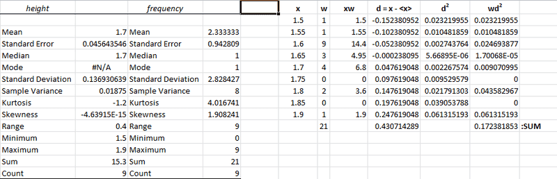

Spreadsheet with two columns of summary statistics for height and frequency (mean, standard error, median, mode, standard deviation, variance, kurtosis, skewness, range, min, max, sum, count), plus a table of x, w, xw, deviation, squared deviation and w times squared deviation values with a SUM cell of 0.172381853.
Actually it wasn't just the mean, I didn't round anything till I solved for the standard deviation. Though what I ended up with was in the hundredths place!
SD = [itex]\sqrt{0.172381853/20}[/itex]
SD = 0.0928390686
I really don't understand what kind of math error I'm doing or if I'm missing something?
santoki said:
SD = 0.0928390686
That's the right answer (now). You must have made a mistake in how you put it into Excel.
I've rechecked my data on Excel and it matched up. I've only highlighted the x and w columns to make a descriptive statistics analysis on Excel and came up with that.
Do you have any idea what could have caused the two answers to be a decimal place away from each other?
[strike]Ah, the denominator in the square root for SD is not the sum of the weights -1, but the number of observations - 1, so 8. Then you get 0.147, so you report <x> = 1.65 +/- 0.05 with a standard deviation of 0.15[/strike]
Edited: no, the ∑w -1 should be in the denominator.
I had a hard time finding the smaller discrepancies, but: there seems to be a 0 missing in the d for x=1.65.
Code:
		x	w	xw		d	d^2		wd^2
		1.5	1	1.5	-0.152380952	0.023219955	0.023219955
		1.55	1	1.55	-0.102380952	0.010481859	0.010481859
		1.6	9	14.4	-0.052380952	0.002743764	0.024693878
		1.65	3	4.95	[B]-0.002380952[/B]	0.000005669	0.000017007
		1.7	4	6.8	0.047619048	0.002267574	0.009070295
		1.75	0	0	0.097619048	0.009529478	0.000000000
		1.8	2	3.6	0.147619048	0.021791383	0.043582766
		1.85	0	0	0.197619048	0.039053288	0.000000000
		1.9	1	1.9	0.247619048	0.061315193	0.061315193
	Sum	15.3	21	34.7	0.428571429	0.170408163	0.172380952
	XL mean	1.70
	XL stdev	0.136930639
weighted actual
	<x>		[B]1.652[/B]		(from 34.7/21)
[strike]	SD		0.147		(from sqrt( 0.17238/(9-1) )[/strike]
	SD		0.09283		(from sqrt( 0.17238/([b]20[/b]-1) )
Edited: Sorry to make a mess of things. Now I really have to think what the best estimate for the uncertainty in the mean is... probably sd/√∑w = 0.0202, so you would still report something like
1.65 +/- 0.02 with σ = 0.09

I checked my calculation for x = 1.65 and you were right, I three zeroes instead of two. My last question is that why did the N (21) from N = ∑w and <x> = (∑xw)/N changed to the N (9) in the SD formula. Wouldn't that be unclear for students and would all make the same mistake of using 21 as N for each column?
So your SD 0.093 was correct. As Haruspex already stated. :redface: I was so embarrassed I forgot the ##\Sigma##w that I edited my last post. Somewhat confusing, I'm sorry to say.
Your 3 zeros instead of 2 surprised me: why not let XL do the work ?
Then: why XL Descriptive statistics doesn't do what you expect: well for the height because it isn't weighed. For the frequency it calculates the average weight (21/9) which isn't what you want. I don't know how to seduce XL to take the weights into account as weights, so I had to trick it by simply typing 1.6 nine times, 1.65 three times, etc. Then Descriptive statistics does do the remainder of the work:
Code:
Test
Mean			1.652380952
Standard Error		0.020259093
Median			1.6
Mode			1.6
Standard Deviation	0.092838826
Sample Variance		0.008619048
Sum	34.7
Count	21
