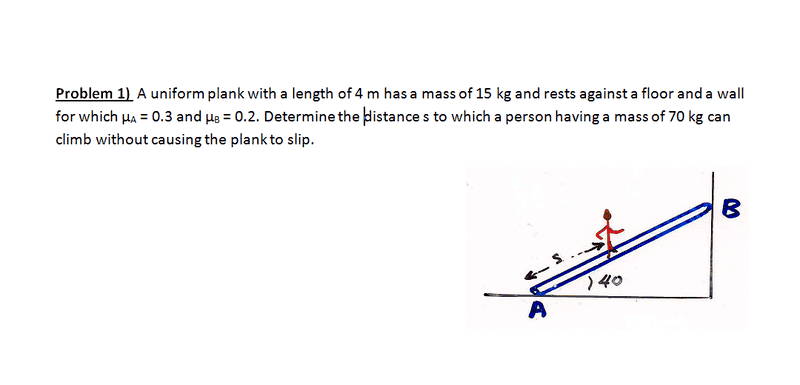

Static friction problem for person to walk up plank

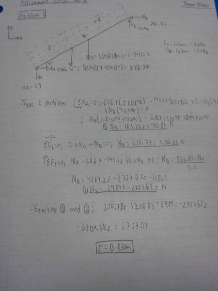

See my work.
You used the wrong trig function, you multiply all forces by sin40 except for friction going up, that's when you use cos40 .
Shouldn't the weights be multiplied by cos(40) because they are vertically downwards, so the moment arm would be the horizontal distance?
You're right, my mistake.
The answer I get still doesn't match yours, but I can barely see the text, do you have a clearer picture of the solution?
Yeah my bad, the quality is horrendous. Here's a way better one:
You used the wrong equation during the final step. Set 165.22s + 70.81 equal to equation 2. That should get you the correct answer.
Wow that was such a silly mistake haha. Thanks for pointing it out! I got 1.00m as the answer.
