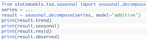

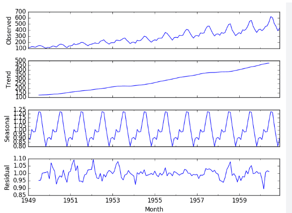

Well, the idea is generally to use that time series to build a statistical model like AR, MA, ARMA, ARIMA, etc. These models require the series used to build them to be stationary. So if our series is not stationary, we need to make it stationary via transformations like differencing....
However, during exploratory analysis, we can use functions (ex: in Python) that can separate out the components so we know what kind of time series we are dealing with and figure out the appropriate transformations to stationarize it:

What tools or processes are you considering using to analyze a time series? R is a popular statistical package. It has a function, decompose, which helps you to see the trend, seasonal, and irregular components. (see this) But it seems that their time series analysis function, acf, which determines autocorrelations works on the original time series. I have never used R for a complete time series analysis, so I will have to leave this for others to say more.
