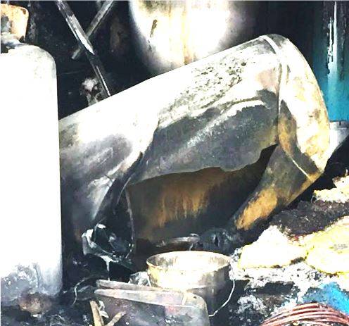

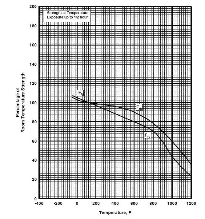

Was that tank in a fire? If it was, then the sheet metal tank wall above water level would heat up fast, while the water would only heat a little. The air temperature inside would increase to a temperature higher than the water temperature and lower than the steel temperature. The air pressure would increase with air temperature. Steel gets weaker at high temperatures. Here is a plot from MIL-HDBK-5J showing how the strength of a particular low alloy steel varies with temperature. It does not apply to the alloy used in your water tank, but does show the trend:
The air pressure rises while the tank wall weakens until it fails. It is likely that you had an air, not steam, explosion. When a pressure vessel fails by excess pressure, the failure mode typically starts as a small crack that spreads at the speed of sound in the steel. The air inside rapidly departs the tank, and quickly expands until reaching ambient pressure.

Yes, the tank was heated by a source outside the tank, but it's not clear what type. The fact that the tank showed a big vertical crack down the middle, does this tell us anything about the type of heat that caused the tank overpressure? Meaning was it a "fast heat" (going to high temperature in a split second), or a "slow heat" (going to high temperature in minutes). I suppose if it's "fast heat", then the container wall will likely fail before the water could turn into steam (high thermal mass of water), so resulting in an air explosion as jrmichler suggested. If it's "slow heat", then maybe water has a chance to boil and over pressure the tank, in which case maybe the valves should break off first as Twigg initially suggested?

There was only a small amount of water in the tank when it was heated by the external fire.
The water in the tank boiled and built up steam pressure, until the tank ruptured, and the remaining liquid water flashed to steam. The fire took some time to heat the tank. It was not an instantaneous process, until the tank ruptured.
There are signs of burning localised to the area surrounding the split in the tank. The coincident position of the burn and the split, suggest that the temperature of that wall rose significantly above the boiling point of water, which weakened the steel.
Internal pressure in a thin walled cylinder causes a hoop stress that is twice the axial stress. That explains why a longitudinal split is seen in the walls of cylinders that rupture due to internal pressure.

Another strange thing is the skinny cylinder immediately to the left showed some charring from the top?
I wondered about that thinner cylinder. Did it contain fuel gas? Has it burnt off hoses or blown out a fusible plug designed to relieve pressure during a fire?
Was the split tank mounted above that thin container?
Was the split tank mounted vertically or horizontally? How far has the split tank moved?
What is a WR-360?
Baluncore said:
I wondered about that thinner cylinder. Did it contain fuel gas? Has it burnt off hoses or blown out a fusible plug designed to relieve pressure during a fire? Was the split tank mounted above that thin container?
Was the split tank mounted vertically or horizontally? How far has the split tank moved? What is a WR-360?
The skinny cylinder on the immediate left of the split tank is an EMPTY heavy duty gas cylinder, it was used to store propane, but it contained just air at the time of fire, and it does not appear to be damaged. Both the split tank (WR-360) and the skinny cylinder stood vertically along the wall, next to each other. After the incident, the split tank did not really "move", its wall just split and it slumped over and leaned to the right (as in the picture).
The WR-360 is the "split tank", it is described HERE ...it is a lightly pressurized tank (38 PSI) with a rubber bladder inside that may contain up to 40 gallons of water. It is connected to a well water pipe system, when the piping water pressure is low, it pushes water into the system to prevent backflow. The tank is built to withstand a maximum pressure of 125 PSI.

seeker11 said:
The only thing that is clear is the WR-360 got roasted by something really hot.
That fuel gas cylinder must be the prime suspect. It is burnt heavily at the top, but not on the sides, and it was placed with the top close to where the heated and split patch on the WR-360 would have been. Can you examine the fusible plug at the top of that gas cylinder?

The WR-360 exploded due to internal pressure. I see no way it could possibly have filled with propane-air mix, and then been ignited.
A fuel gas cylinder should be stored in a ventilated area, not enclosed inside a building structure. That is also true for “empty” cylinders. A child could have opened, and then not completely closed the propane valve. There may have been a propane fire at some stage, but there was no propane explosion. If a general fire in the area caused the fusible plug in the propane cylinder to melt, the propane would escape and burn like a blowtorch. If the propane cylinder was almost empty, then heating the cylinder could drive out the remaining gas.
There was a general fire in that space. If the space was poorly ventilated, it may well have burned quietly, without sufficient oxygen, reaching high temperatures over a long period of time. The plastic on the floor was relatively cool while the thick smoke at the top was very hot. That “stratified” profile would explain the variation in damage. The steam explosion of the WR-360 would have ventilated the area by bursting the enclosure, which may have removed the source of heat and so extinguished the fire.
There is insufficient evidence or information to come to any conclusion. All we can do is keep expanding the possibilities.

Note the deformation of the weld line between the cap and the cylindrical wall.
It seems to me that a pre-explosion fire weakened that area of the tank, as a shape of triangular metal got peeled back from there by escaping steam.
That is not the typical shape of metal failure induced purely by internal pressure.

I am not convinced that "a triangular shape of metal was peeled back".
This was a thin walled cylinder, not a thick walled high pressure cylinder.
The split in the cylinder wall ran both up and down until it reached the weld lines, where it was stopped. As the split opened outwards releasing the steam, the cylinder walls on each side of the split were in axial tension, which pulled the ends of the cylinder in, bending the welded seams towards the split.

I apologize. The WR-360 is filled with about 40 gallons of water and it does not contain any propane. There was another tank leaking propane into the building which the WR-360 sits. What we are trying to figure out post-mortem is, if there was a propane gas explosion in the building (a flash fire), could that cause the WR-360 to rupture the way shown in the picture?
The alternative scenario is that the propane-air mixture inside the building was not rich enough to combust, and a non-gas fueled fire broke out near the WR-360 and slowly heated up the WR-360 and caused the rupture. We are trying to figure out by looking at the picture and assess if certain hypothesis could be excluded.

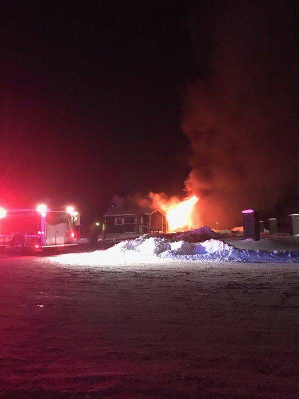

A propane gas explosion in the building could NOT have damaged the WR-360 in that way.
The water in the WR-360 was heated for some time, it boiled, then internal pressure burst the WR-360. Just what the source of heat was that boiled the water is not clear. It might have been the general fire in the enclosed space, it may have been helped by gas burning as it escaped from the adjacent propane cylinder.
If propane leaked and collected in the enclosed space, then it may have been ignited some time later by a spark, from say a thermostat switching. That could have started the general fire. I would expect that a propane explosion would have both opened the structure and started the general fire. That general fire may have melted the fusible plug in the adjacent propane cylinder and released sufficient gas to help weaken the WR-360 wall and boil the enclosed water.
If a propane explosion did not open the building earlier, I would expect that the WR-360 steam explosion would have opened and vented the building.
Yes, there was a propane heater mounted on the wall inside the building that turns on when it gets cold, and that was likely the ignition source since it coincides with the timing of the fire. The building did catch on fire, and the building inside got hot, this is the general fire that weakened the WR-360 wall and caused the rupture (the adjacent "skinny cylinder" was empty so it was inert). So this timing seems to fit the evidence, gas explosion -> general fire -> WR-360 rupture.
