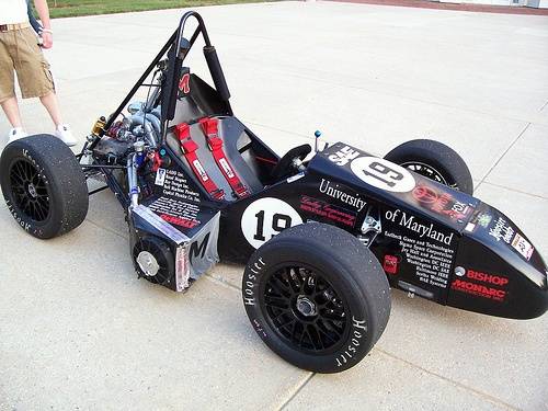

Photo of a black University of Maryland Formula SAE open-wheel race car with a roll hoop, racing slick tires, and red seat harnesses, parked on pavement.
That's what our car looked like for those of you who are unfamiliar with SAE. By "our" I mean our school, I wasn't on the design team but will steal credit for their victory shamelessly.
