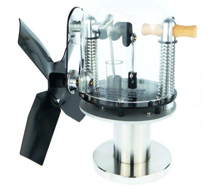

How much power do you need to be successful?
Enough to light a LED?
Enough to supply your whole house?
If you want just enough power to circulate hot air from the stove, search stirling engine stove fan. Lots of hits. Here is an image from one randomly picked hit:
If you built an engine powerful enough to generate serious power, it would take all the heat from the stove, extract some mechanical power, and send the remaining heat outside. The stove would not heat the house. If the rejected heat went into the house, the efficiency would be a little lower because of the smaller temperature difference. If the engine was 10% efficient, 90% of the stove heat would go into the house.
