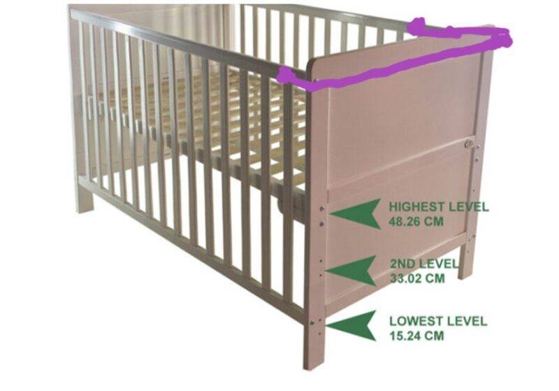

A typical baby crib look like.
For the above, the width is 30 inches. The length of the railing is 52 inches.

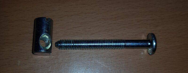

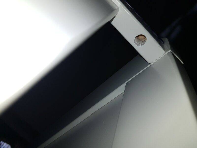

The railings were only connected top and bottom at the sides with a a single Allen screw and round nut (inside the New Zealand Pine Wood). (Taken out temporarily to photograph it)

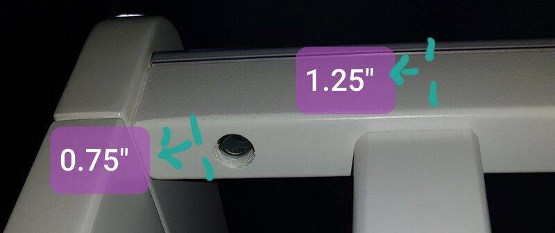

This is the dimensions of the railing (with installed screws (left side)). The vertical is 1.25" and horizontal side is 0.75".
How strong is the railing when say 1 to 2 year old baby tried to push it outward before it breaks?
This crib is very common so there must be studies or standard computation about its strength?
What is the unit of the force? Can you please help compute the force? Thank you!
My IKEA chair is supporting me with four bolts like those.

When I look at the rail side view or from the edge. I can see the rail pine wood flex when baby tried to hold the rail outward from middle of crib. How much can pine wood flex?

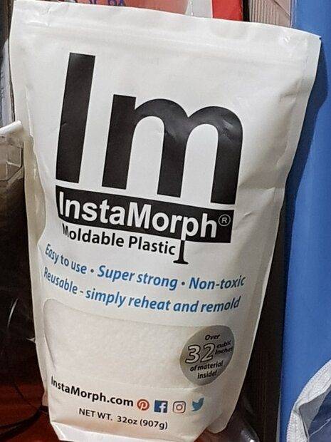

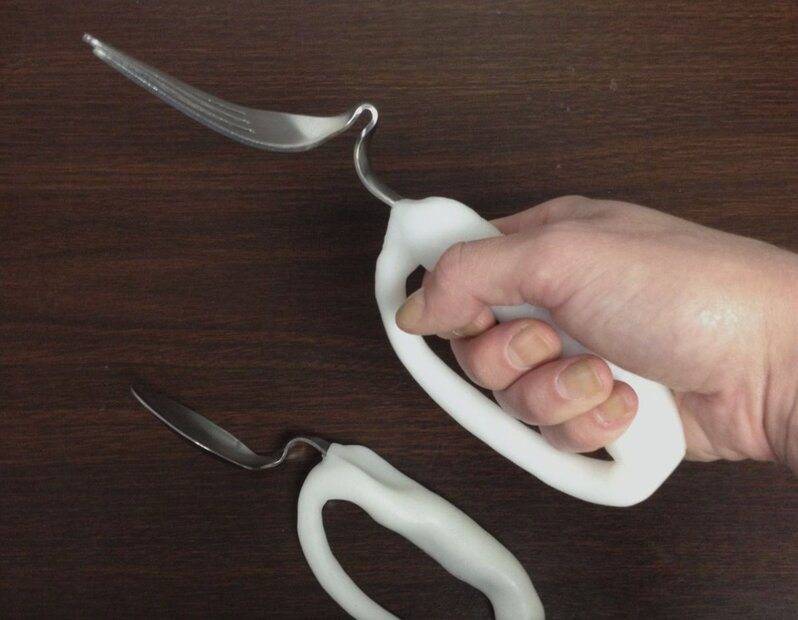

Anyway I have a bag of Instamorph, a non-toxic, lightweight polyester thermoplastic that is moldable at low temperature (150 degrees Fahrenheit) and solidifies at room temperature
Anyone has idea what housing or formwork to create to make a bar made of Instamorph that would brace the ends of both rail about 2" from the edge? I'm thinking of enclosing them in plastic sheet but the plastic may melt. This is to make the rail more stable. To mold the moldable thermoplastic. I have to put it in a bowl of boiling water. But the bowl is small. How can I make it into a 31 inches bar bent at 90 degrees at end to hold the rails 2" away? Any idea? Thank you.
View attachment 284573Anyone has idea what housing or formwork to create to make a bar made of Instamorph that would brace the ends of both rail about 2" from the edge? I'm thinking of enclosing them in plastic sheet but the plastic may melt. This is to make the rail more stable. To mold the moldable thermoplastic. I have to put it in a bowl of boiling water. But the bowl is small. How can I make it into a 31 inches bar bent at 90 degrees at end to hold the rails 2" away? Any idea? Thank you.View attachment 284572
You want to make an adjustment to the crib?
Make sure the baby cannot loosen any of the added parts, chew on it, break a piece off and choke.
And any additions may void recourse if any future event does occur.
