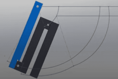

Hello, a friend of mine asked me to create a mechanism for a tri-folding gate. The thing is: it has a peculiar sequence when it's opened and I'm really stuck thinking this mechanism. Is there a good book/source about mechanics where I can find inspiration? Thanks in advance

Sorry, I forgot to attach some sketch. Here's a video of how the gate should move. Just a quick representation of the sequence.
Regarding your fan-fold door, this is a common scheme for closets in the US. The door will have pins at the top and bottom following a straight track to ensure it opens correctly.
In your case, it seems that there is an additional constraint: the door can't pass a certain horizontal boundary. Is that correct?

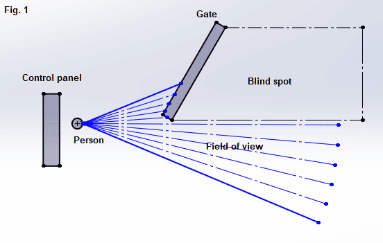

If it is a gate for people or animals, it will be very dangerous.
The third leaf operates like a cutter, against the right-hand post, (not shown).
The leafs one and two reach a maximum velocity, with maximum force being applied along leaf three, as the gate finally closes.
A person trapped at the end of leaf three, will be unable to reach the hinge between leafs one and two, to relieve the pressure or escape being crushed.

It's for a very specific furnace. The sequence it's peculiar due the limited space.

It's not for living beings. Specific application. And it can't operate if there are persons close to the gate. Also it will operate at a low velocity.

Yeah, that is the sequence due a limited space. Sadly there are no other options.
That greater-than-90° motion for pivot #1 makes this somewhat involved. If you can get the pivots points on a straight line, it is trivial.
I realize the gray lines show the travel paths, however I am assuming that the two horizontal lines would comprise a physical track for the traveling gate joints, and also enclose a chain and a cable (or 2 chains).
Anyhow, here goes.
Referencing your video,
Starting at top left, label the fixed pivot #1,
the middle pivot #2
then #3
Motive power at the right end of the track.
Two roller chains needed for unfolding (or cable + roller chain):
Rotate links #1 & #2:
A cable/chain inside the track, with an idler pulley in the track where pivot #3 enters the straight track. End of rope/chain attached to gate near pivot #3 and to motive power at right end. Pull until pivot #3 enters track
Rotate all links, straightening gate:
Continuous Roller Chain inside track with idler to left of where point #3 enters track.
Pivot #3 has a sprocket that engages roller chain. Sprocket turns drive axle that straightens pivot #3 (unfolds last segment of gate).
When last gate segment hits rotation stop, the entire gate starts extending to Closed position.

Thank you so much Tom I really appreciate your time. But there is one problem, when I explained this to my friend he told me that the starting point is at 180° not at that >90° angle. It seems there was a change of plans. They decided to change the starting point because the gate would block the view of a person (Fig 1). The new sequence starts like in Fig 2. Sorry for asking for help in this new sequence but I'm lacking of time and creativity in this mechanism, I'm doing this in my little free time
Unless there are other constraints, that makes the solution trivial.
If other constraints exist, please supply a drawing.
Use 3 (or more) sliding sections that, when retracted, are in front of each other. Slide them to the right when needed. similar to a large panel truck whose side cargo door slides to open; another example is a "pocket door", more often seen in older houses where a door slides inside a wall to open.
Again, use a continuous chain or cable to close/open the gate.
