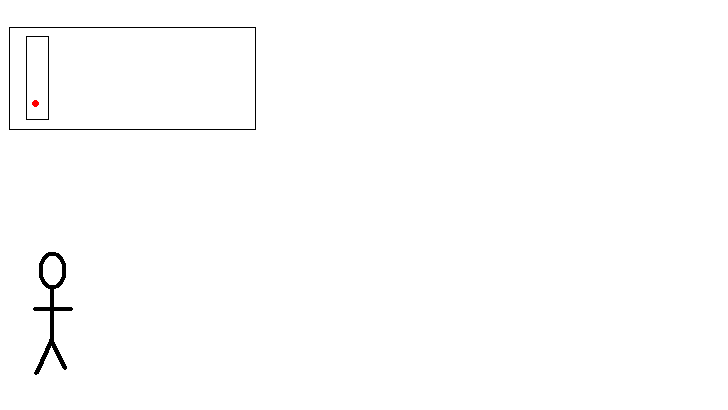

The speed of light in a vacuum is a constant value in any non-accelerating frame of reference, and it is a very high speed. To illustrate this, think of someone with a tube that bounces photons around vertically, who is on a train moving at 20 m/s. To the guy on the train the photons move only vertically, but to an observer on the ground they also move horizontally, making their total distance moved greater. Since speed is distance divided by time, and since light moves at the same speed for both of these peope, we can calculate the time it takes for a round trip from the top of the tube, to the bottom and back up for each observer. For the guy on the outside, the light traveled a greater distance at the same speed, so time happened faster for him than the guy on the train.
Using similar ideas, we can generalize by saying that as an object approaches the speed of light, its length decreases, its mass increases, and time slows down for it.
Now consider if the speed of light were walking speed, and tell us what you think would happen in your everyday world.

  • Stick-figure person standing below a rectangular box containing a vertical tube with a red dot near its bottom, drawn in simple line art.
I understand your explanation, but let me try to answer your question...
If the speed of light were represented by a guy walking with a tube of protons that bounce vertically, then:
time would slow down. the length of each bounce would increase (because of relativity?) and the mass would be smaller?

Unless your everyday world consists of guys who walk around with tubes of photons, I was getting at something slightly different :smile:
Since nothing can move faster than light, and you know the effects of moving near the speed of light, and if the speed of light were all of a sudden 10 km/h... what would happen to you if you went for a run. What is the fastest you could run then? How would your length, mass, and perception of time change?
Mass increases as you reach the speed of light, and the speed of light is the maximum speed. If the speed of light became 10 m/s, then nothing could move faster than 10 km/s, and mass would increase much faster.
