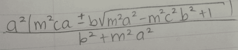

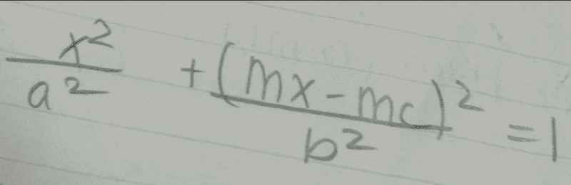

I am trying to solve for x in this equation:
I tried solving it like a quadratic equation.
This is the most simplified I could get it.
Can someone please help me find a simpler expression

Can you please show all of your work and intermediate steps? Thanks. :smile:

Maybe there isn't a simpler expression. Not all simple-looking problems have simple-looking solutions. Anyway, I get a different answer.
A useful habit is to check whether a simple solution to the one expression is also a solution to the other. Your original has the solution x=a=c. That does not appear to be a solution of your final expression.

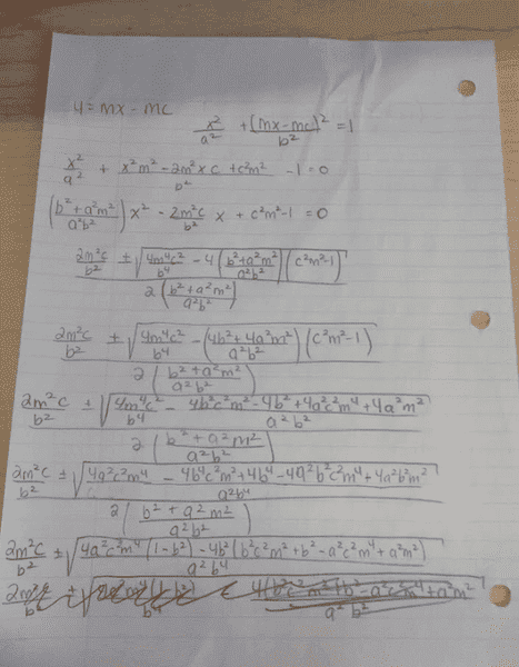

and then i just simplified to my final answer
Third step, shouldn't it be ##\frac{c^2m^2}{b^2}## instead of ##c^2m^2##?
I would have multiplied through the first equation by ##a^2b^2## to get rid of the fractions.
Did you read post #4? You can make further use of this by plugging in the simple solution at various points in your working to see at what point it ceases to be a solution.
