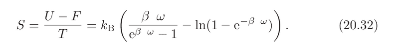

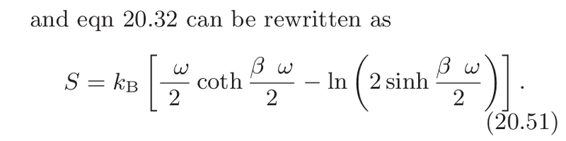

From Blundell and Blundell Chapter 20 Problem 20.3.
I have proved that $$1-e^{-\beta \omega}=2\sinh\left(\frac{\beta \omega}{2}\right)$$ with no problem, but I am stuck on the ##\coth## term. I have tried to solve this but it gets messy and I'd rather not include them here. Thanks!

The expression just looked wrong to me. There is a factor of ##\beta## missing in (20.51). It should be:
$$\frac{\beta \omega}{2}\coth\big (\frac{\beta \omega}{2}\big )$$
yeah I'm getting the same as you now. As in, I have the book answer, but the book is missing a factor of ##\beta## on the first term
I have not done the explicit computation (just visualized how the terms would combine), but apart from the missing ##\beta## the overall identity looks quite reasonable to me.
