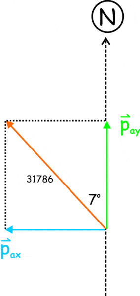

A suburu WRX and a Honda Accord have collided at an intesection. The suburu was initially traveling north. The honda was traveling west, about to initiate a right hand turn.
Obsercation of the scene of the accident and interviews with witnesses yeilds the following information:
1. The driver of the honda was a 52 yr old man of average build
2. The driver of the suburu was a 24yr old man of average build
3. After the impact the two vehicles traveled as one object
4. A witness states that neither driver appeared to break prior to the collision
5. The length of the skid was 12.8m in a direction N 7degrees W
6. The mass of the honda is 1400kg
7. the mass of the wrx is 1200kg
8. it was a dry day and the coefficient of friction between the tyres and the road is 0.6
9. the road is straight and flat
10. a witness states that the honda was stationary at a stop sign prior to entering the intersection
11. The beginning of the skid mark was 6m from the stop signDetermine the following:

What I would do is use the work kinetic energy theorem to calculate their combined velocity just before they started skidding. Then use momentum conservation for the collision to calculate the velocity of the suburu just before the collision.

Well, you have two objects which you know the mass and velocities of; the impact at right angles; they travel as a single object with which you know the mass and can work out the velocity; you know the distance traveled to zero velocity after the collision; this should give an average deceleration which you can compare to frictional forces...
Apply the theorem to the skidding part of the collision - Assumption: The wrecks came to a halt at the end of it. Show us your results in your next post.

Ok let's do the skidding part with kinematics then.
What force is causing the wrecks to decelerate during the skidding part?
Can you calculate the magnitude of this force?

When a car brakes the wheels slide in stead of roll over the road. Guess what happens when an object slides over a surface? It experiences a frictional force coming from the surface. Try and calculate the magnitude of this frictional force for the combined wrecks.
N=W
= mg
= 1200 x 9.8
= 11760N
F = u W
= 0.6 x 11760
= 7056N
Am i on the right track?
oh hang on i need combined wrecks
not just suburu damn
so i add 1200 and 1400 then x 9.8 = 25480N
then divide .6 = 15288N
? I am not doing this right am i?
Seems fine. Now calculate their acceleration and their initial speed, that is their combined speed before the skidding started.
a = F/m
= 15288/2600
= 5.88m/s
as for initial speed how do i calculate that?
would that be using v2=u2 +2as somehow?
That is correct.
