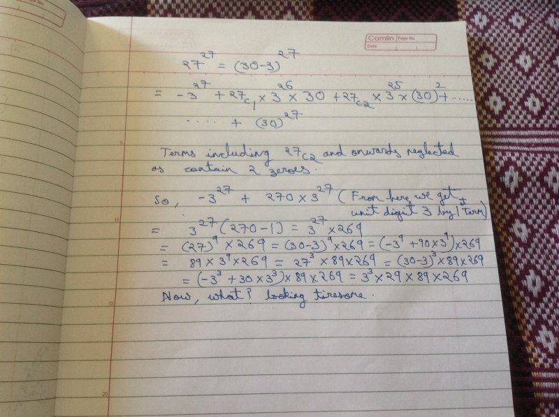

Here I got that approach by binomial theorem.Perok why use pencil when pen is in demand.

"I want to do it myself and possibly learn something" way:
[tex]27 ^ {27} = \left( 3^3 \right) ^ {27} = 3 ^ {81}[/tex]
Now finish it. I find easier to work with a power of 3, you may think differently, though.
I provide two solutions below. I wouldn't peek if I were you, though.
Let [itex]h[/itex] be any integer such that [itex]100 \mid h[/itex].
Note that [itex]h[/itex] is not constant among the expressions below, the only constraints are those abovementioned.
[tex]27 ^ {27} = (25 + 2) ^ {27} = 25^{27} + 27 \cdot 25 ^ {26} \cdot 2 + \ldots + 2 ^ {27}[/tex]
[tex]25^{27} + 27 \cdot 25 ^ {26} \cdot 2 + \ldots + 2 ^ {27} \equiv 25^{27} + 27 \cdot 25 ^ {26} \cdot 2 + 2 ^ {27} \mod 100[/tex]
[tex]25^{27} + 27 \cdot 25 ^ {26} \cdot 2 + 2 ^ {27} = (25+h) + (27 \cdot 50) + (28 + h) = (25+h) + (50+h) + (28 + h) = 3+h \equiv 3 \mod 100[/tex]
[tex]0 + 3 = 3[/tex]
About [itex]2^{27}[/itex]? Know your powers of 2.
I happen to know that [itex]3 ^ {20 + x} \equiv 3 ^ x \mod 100[/itex].
[itex]27 ^ {27} = 3 ^ {81} = 3 ^ {(20 + (20 + (20 + (20 + 1))))} \equiv 3 ^ 1 \mod 100 = 3[/itex]
[itex]0 + 3 = 3[/itex]

And the other digit is 0 (as both my solutions show). I do get it.

If the remainder of the division by 100 was 43 I would finish with 4 + 3 = 7.
As the remainder is 3, I end up with 0 + 3 = 3. Get it? It is modulo 100 and not modulo 10.
As in our high school modular arithmetic is not taught, I am not so acquainted with it. That is one reason for my language looking topsy-turvy. Are you crazy? Why it is looking to you that I am thinking modulo 10 and not modulo 100.
Oh, I now get the whole plot. We are doing mod 100 because we have to look at only tens digit and unit digit. So, dividing by 100 would give us remainder of that number last two digits.

"formula known to you earlier for certain numbers". I know about 3 and 41 by heart.
I do not know if it is a property, I just happen to remember it.
