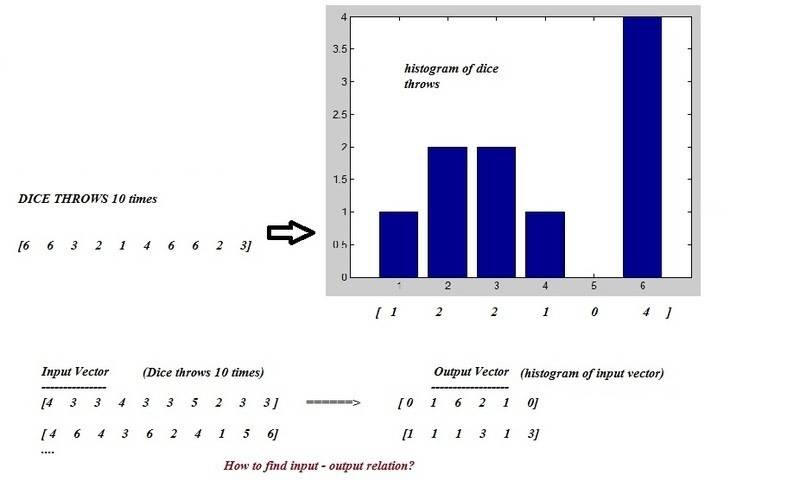

Hi all,
I have an all time doubt here. We know that if r.v z = x + y where x and y are 2 random sequences having corresponding pdfs p(x) and p(y), the pdf of z, p(z) = convolution ( p(x),p(y) ). I have seen the derivation for the continuous case although not thorough how to prove it. I wanted a proof for the discrete case (ie, x , y and z are discrete). I attempted through a straight forward method and got stuck. My method was defining a function which calculates the pmf vector from the input sequence x. I thought I would get an input output relation between input vector x and pmf vector.Even for a histogram I could not do it. Why is it so? Is it because of the nonlinearity?
My aim was to try this:
x1 ----> p(x1)
x2 ----> p(x2)
z= x1+x2 ------> p(z) = p(x1 + x2) = conv(p(x1),p(x2))

ok here goes
by conv(p(x1),p(x2)) I meant convolution of p(x1) and p(x2).
  • Diagram of dice throws: a list of 10 dice results, an arrow to a bar histogram of the counts for values 1 to 6, and below it input and output vectors showing a histogram of input vector values.
dexterdev said:
ok here goes
Are you unable to explain how the function conv(..) works?
Can you calculate the probability that the sum of the dice is 4 from your data?
