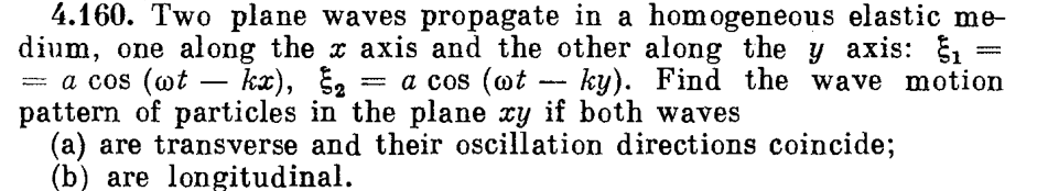

The discussion focuses on combining two waves to create Lissajous figures using vector addition. The first method involves adding the oscillations directly, represented as ξ1 + ξ2, while the second method employs the Pythagorean theorem to combine orthogonal vectors, expressed as √(ξ1² + ξ2²). The particles' motion is described in the xy-plane as ξ1 e_x + ξ2 e_y, which accurately depicts the formation of Lissajous figures.
