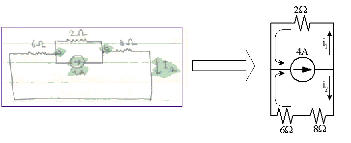

Hello, :smile:
I was doing a superposition problem and got stuck on this point: http://img810.imageshack.us/img810/1866/superti.jpg
Please help me out. Thanks
Cheers
You're right, you have a current divider situation:
Thanks a lot for the diagram. Now I understand it and have solved the problem.
