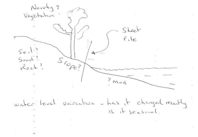

How about a dimensioned cross section?
I will absolutely provide that at a later time. I have to go down there and make measurements. I will post a sketch of it next week sometime as I will be going out of town. In addition...I really do appreciate all the help. Thank you very much
Something to indicate the shape of the lake side will be needed ie how steep is the bank?
Some ideas about what might be useful contributory information.

Further question.
What is known about the groundwater in the area?
Are there any sewers, road drains, land drains (including slit trenches) or other pipes than may be blocked or damaged?
Are there any springs on the slope above the level of the pile?

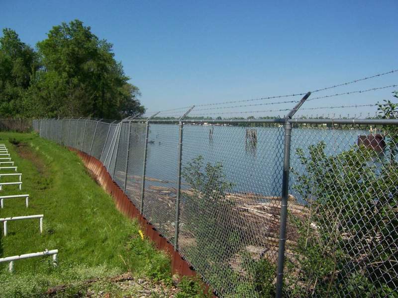

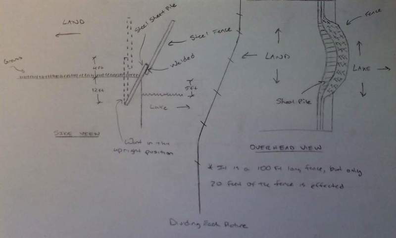

Here is a photo taken of the fence I have described. A sketch of the area will be attached as well

Here is the supplemental sketch...thanks again!

Thanks for the pictures, the situation is fairly clear.
In the picture you can see where the ground has slumped to a trench or furrow behind the displaced piles. This shows as a brown gash in the green turf.
Almost certainly, the water has undercut these piles so pulling the tops back will be counterproductive in that the whole zone may give way.
Are you sure there is no pipe entering the water beneath these piles?
You say they are only baby piles (12ft long). Your best bet would be to get a JCB and push them in further with the bucket, welding extensions on the top if necessary. This would be a quick and cheap operation and not leave any dangerous anchor cables at the surface.
