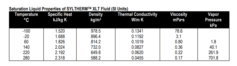

Hi, cannot get a definite answer anywhere on how heat transfer occurs with this fluid. All that the manufacturer gives is "excellent heat transfer". Water has excellent heat transfer due to convection currents. Need to know if this fluid also heats by convection rather than conduction. Conduction can be a very slow process. Viscosity of this fluid close to water which may be a good indication that it heats by convection.
Cannot test because I cannot get a small sample of 4 LITRES. Manufacturer will only supply a barrel for $1900.
Does anyone know on this forum? Have tried the manufacturer but they don't seem to know the difference between convection and conduction. Thanks.

It's all in the datasheet. Amazing what you can find with google.
https://www.dow.com/documents/en-us...01468-01-syltherm-xlt-heat-transfer-fluid.pdf
BTW, discounting metals, I think all liquids move heat better by physical transport (convection, or turbulent flow) than conduction. The big thermal gradient at the surface when a new, cold, molecule pushes out the older hotter one is a big advantage. Plus, in my limited experience, they are all crappy conductors.

The reference you have given just says excellent heat transfer. It doesn't say what kind of heat transfer it is, convection or conduction. The difference determines if the liquid takes minutes or hours to heat up.
There's no magic here; all fluids transfer heat by convection and conduction. The more viscous, the less convection. What dominates/matters depends on the application.

I think you misunderstood, that was exactly my point. For liquids to move heat effectively the molecules have to move, they typically have high thermal resistivity. If you stirred that tank the temperature gradient would have been much smaller.

Did you look at page two? They give you about as much data about their material as they can.
Table of saturation liquid properties of SYLTHERM XLT fluid in SI units, listing temperature in °C, specific heat, density, thermal conductivity, viscosity and vapor pressure at six temperatures from -100 to 280.
What they can't do is tell you how your system will work. Convection depends on the details of your application. That part is your problem, not theirs.
