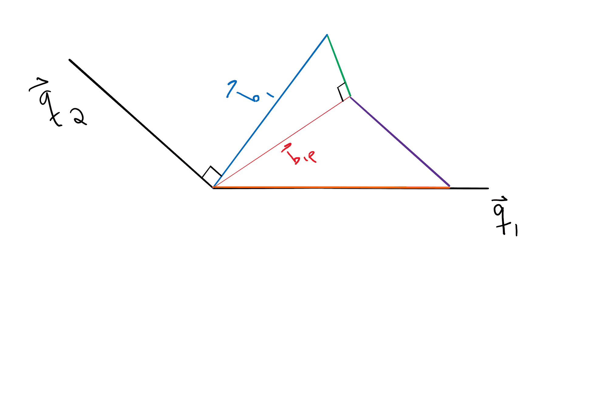

Hi mathmari and Klaas van Aarsen,
I want to politely and respectfully suggest that the analysis for the solution to the system $Ax = b_{p1}$ -- i.e., where $b_{1}$ has been projected to the column space of $A$ -- should be re-examined. In particular, the projection of $b_{1}$ onto the column space is not given by \begin{equation*}b_{p1}=(b_1^Tq_1)q_1+(b_1^Tq_2)q_2=1\cdot q_1+0\cdot q_2=q_1.\end{equation*}
Please refer to the attached image.
The projection of $b_{1}$ onto the column space of $A$ is the "shadow" $b_{1}$ casts on the plane determined by $q_{1}$ and $q_{2}.$ Here, $b_{1}$ is shown in blue; $b_{1p}$ is shown in red; and $q_{1}$ and $q_{2}$ in black. As we can see, it is possible for $b_{1}$ to be orthogonal to $q_{2}$ in $\mathbb{R}^{3}$, yet its projection onto the column space will contain a $q_{2}$ component nevertheless. The equation we must consider is $$b_{p1} = c_{1}q_{1} + c_{2}q_{2}\qquad (1).$$ Visually speaking, the magnitude of $c_{1}$ and $c_{2}$ are given by the lengths of the orange and purple line segments, respectively.
How do we solve for $c_{1}$ and $c_{2}$? This is done by taking dot products of (1) with $q_{1}$ and $q_{2}.$ It is very important to note here that $q_{1}$ and $q_{2}$ are not orthogonal, so $q_{1}\cdot q_{2}$ will not vanish. Doing this will yield a system of 2 equations that can be used to solve for $c_{1}$ and $c_{2}$. From there you can proceed to solving $Ax=b_{p1}$ using the row echelon technique applied previously.View attachment 9680
Oh yes, I forgot to take into account that $q_1$ and $q_2$ are not perpendicular in addition to not being of unit length. (Blush)
So isn't there a general formula? Do we have to derive the formula by solving the system for $c_1$ and $c_2$ ? (Wondering)
As I see it, we can do one of:
1. Set up the system and solve it as GJA suggested.
2. Orthogonalize $q_1$ and $q_2$ and use the formula that you already used. We can use $\tilde q_2=q_2 - (q_2\cdot q_1)q_1 / \|q_1\|^2$ for that (Gram-Schmidt process).
3. Use the formula $\text{projection}(b)=b-(b\cdot n)n$, where $n$ is a vector of unit length that is orthogonal to both $q_1$ and $q_2$. It's the projection to the space normal to $n$, which is the desired space.
(Thinking)
I would suggest using equation (1) from my previous post and taking dot products of it with $q_{1}$ and $q_{2}.$ If that is too vague, here are some details that will hopefully make it make clear what I am suggesting. Note that $$b_{1} = c_{1}q_{1} + c_{2}q_{2} +c_{3}n,$$ where $n$ is a non-zero vector orthogonal to the $q_{1}$-$q_{2}$ plane. This is the mathematical way to express the fact that in the picture I posted $b_{1}$ equals orange + purple + green. Since $$b_{p1} = b_{1} - c_{3}n,$$ (1) becomes $$b_{1} - c_{3}n = c_{1}q_{1} + c_{2}q_{2}\qquad (2).$$ Taking dot products of (2) with $q_{1}$ and $q_{2}$, we get $$b_{1}\cdot q_{1} = c_{1}q_{1}\cdot q_{1} + c_{2}q_{2}\cdot q_{1}$$
and $$b_{1}\cdot q_{2} = c_{1}q_{1}\cdot q_{2} + c_{2}q_{2}\cdot q_{2},$$ because $n\cdot q_{1} = 0 = n\cdot q_{2}$.
If you work out those dot products you can get the system of equations for $c_{1}$ and $c_{2}$. Solve this system for $c_{1}$ and $c_{2}$, then solve the $Ax=b_{p1}$ equation using the row echelon technique you previously applied.
