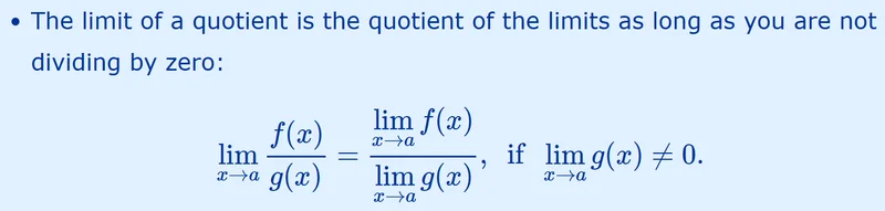

Your step:$$\lim_{x\to0}\frac{\frac{\tan(\tan x)}{tan(x)}\cdot\frac{1}{sin(x)}-\frac{\sin(\sin x)}{sin(x)}\cdot\frac{1}{tan(x)}}{\frac{1}{sin(x)}-\frac{1}{tan(x)}}=\lim_{x\to0}\frac{1\cdot\frac{1}{sin(x)}-1\cdot\frac{1}{tan(x)}}{\frac{1}{sin(x)}-\frac{1}{tan(x)}}\tag{1}$$is wrong. Focus on the first term in the numerator on the left-side:$$\frac{\tan(\tan x)}{\tan x}\cdot\frac{1}{\sin x}=\frac{\tan(\tan x)}{\tan x}/\sin x\equiv f(x)/g(x)\tag{2}$$Now it's true that ##\lim_{x\rightarrow0}f(x)=1## (as you observe) but it's also true that ##\lim_{x\rightarrow0}g(x)=0##, which means ##\lim_{x\rightarrow0}f(x)/g(x)\neq\lim_{x\rightarrow0}1/g(x)##. The limit of a quotient is not the quotient of the limits whenever the limit of the denominator is zero:
(from https://web.ma.utexas.edu/users/m408n/AS/LM2-3-2.html)
This same observation also applies to the second term in the numerator on the left-side of eq.(1).
But what you can do instead is to apply L'Hôpital's rule to the left-side of (1) and show:$$\frac{\lim_{x\rightarrow0}\frac{d}{dx}\left(\frac{\tan(\tan x)}{tan(x)}\cdot\frac{1}{sin(x)}-\frac{\sin(\sin x)}{sin(x)}\cdot\frac{1}{tan(x)}\right)}{\lim_{x\rightarrow0}\frac{d}{dx}\left(\frac{1}{sin(x)}-\frac{1}{tan(x)}\right)}=\frac{1}{1/2}=2\tag{2}$$as expected.

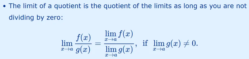

Ah, I see. So alternatively, the limit of the product is NOT the product of the limits when either ##f(x)## or ##g(x)=\frac{1}{0}=\infty## (which is essentially the same as saying the limit of the quotient is NOT the quotient of the limits when the denominator is 0). I was trying to solve it without the help of L'Hopital's Rule, otherwise I would have applied it from the get go since we get the indeterminate form of ##\frac{0}{0}## right away...I should have mentioned that. Nevertheless, at least I understand now why my method wasn't working. Thank you.
