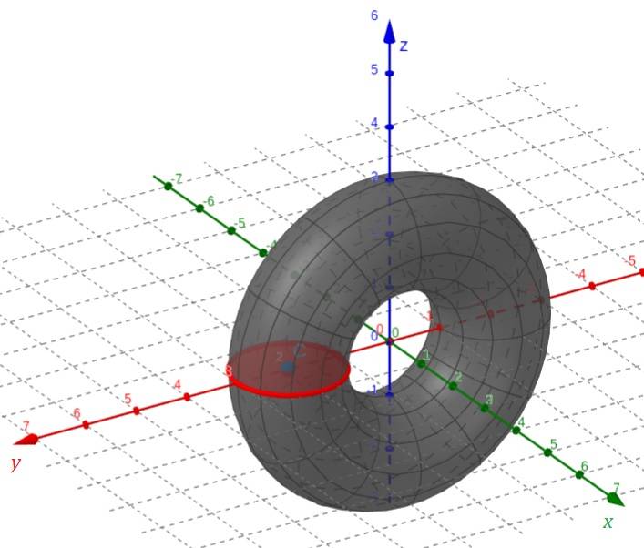

I can derive the volume for a ring torus (a ring toroid of circular cross-section), but I'm struggling to do the same for [I]any[/I] elliptical toroid
Like the title and the summary suggest, I can derive the volume ##V=2\,\pi^{2}\,r^{2}\,R## for a ring torus - a doughnut-style toroid (one such that the major radius ##R## > the minor radius ##r##, and it therefore has a hole at the center) that is of circular cross-section. But I want to be able to prove the general case, that is, derive the volume of any elliptical ring toroid, including those of non-circular cross-section (those with an elliptical cross-section of non-zero eccentricity, and therefore have semi-major and semi-minor axes ##a\neq b##).
I run into a road block at a point in my integration where I have to make a trigonometric substitution. Specifically, I'm having trouble getting the upper bound of integration I want while making this change of variables from ##x## to ##\theta##. I had to do a trig substitution while deriving the volume of the ring torus (the one w/ circular cross-section) as well. ##\sin\theta## ended up being equal to 1, so ##\theta## (and therefore my upper bound) ended up being equal to ##\frac{\pi}{2}##, and everything worked out beautifully...
...not so with the one of elliptical cross-section. Unfortunately I don't really know how to show you where I'm hitting a roadblock without simply starting at the beginning. So I'll start by posting my successful derivation of the volume of the ring torus of circular cross-section first, and then post what I have so far for the derivation of the volume of a ring toroid of non-circular cross-section up to the point where I get stuck. I apologize in advance for the lengthiness of this post 😂.
DERIVATION OF THE VOLUME OF AN ELLIPTICAL RING TORUS (A RING TOROID OF CIRCULAR CROSS-SECTION):
I started with a circle of radius ##r## in the ##xy##-plane whose center is at the point ##(0,R,0)##, where ##R>r## so that there is a hole at the center of the torus, doughnut-style:

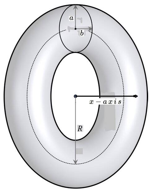

OK...hopefully you're not so bored yet that that I've lost your attention 😆. Now I'll post what I have so far for the derivation of the volume of a ring toroid of non-circular cross-section up to the point that I get stuck...
DERIVATION OF THE VOLUME OF AN ELLIPTICAL PARABOLOID OF NON-CIRCULAR CROSS-SECTION:
I started with an ellipse of semi-major axis ##a## and semi-minor axis ##b## in the ##xy##-plane whose center is at the point ##(0,R,0)##, where ##R>a## (or ##b##, whichever semi-axis is parallel to the major axis) so that there is a hole at the center of the torus, doughnut-style. We have the same setup as before, the only difference being the shape of the toroid's cross-section:
Since the implicit equation of an ellipse becomes two functions when y is solved for x explicitly (its upper and lower halves), what I did was revolve the upper half of the ellipse about the x-axis first, giving me the volume I labeled ##V_{1}##. I then did the same for the lower half, called it ##V_{2}##, and subtracted it from ##V_{1}## to get ##V_{toroid}##. Starting with the equation of an ellipse and solving for ##y##, we have:

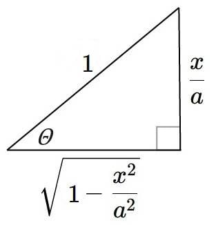

...and now for the integral that required a trig substitution:
  • ##cos\ \theta=\frac{\sqrt{1-\frac{x^2}{a^2}}}{1}\rightarrow\sqrt{1-\frac{x^2}{a^2}}=cos\ \theta##
  • Also, ##sin\ \theta=\frac{\frac{x}{a}}{1}=\frac{x}{a}\rightarrow x=a\ sin\ \theta\rightarrow dx=a\ cos\ \theta\ d\theta##
  • Also, when ##x=0, sin\ \theta=\frac{0}{a}=0\rightarrow\theta=0## when ##sin\ \theta=0## (upper limit)
  • Also, when ##x=b, sin\ \theta=\frac{b}{a}=?\rightarrow\theta=?## when ##sin\ \theta=\frac{b}{a}## (lower limit)
...and this is where I get stuck. Actually, I'm able to carry on with calculating the integral itself, I just can't evaluate it over an interval because I don't know what my upper bound is. In the previous derivation, when the cross-section was circular and I just had a radius ##r## to contend with, you can see that ##sin\ \theta=\frac{x}{r}##, and that ##sin\ \theta=1## (and therefore ##\theta=\frac{\pi}{2}##) when ##x=r##, and everything worked out nicely from there. Now, I feel like the upper bound has to equal ##\frac{\pi}{2}## in this derivation just like in the previous one in order for things to work out in the end. But this time ##sin\ \theta=\frac{x}{a}##, not ##sin\ \theta=\frac{x}{r}##, and substituting in my upper limit ##b## gives me ##sin\ \theta=\frac{b}{a}## which, unless ##a=b## (##=r##), cannot equal 1. So if ##sin\ \theta\neq 1## then ##\theta\neq \frac{\pi}{2}##, and I don't have an upper limit that makes the integral work out nicely. In fact, I don't have an exact value at all...just the formula ##sin\ \theta=\frac{b}{a}## (or ##\theta=arcsin\ \frac{b}{a}##, but I have my doubts about going down that road and substituting in ##arcsin\ \frac{b}{a}## for my upper limit...I can't see that resulting in an integral that isn't messier than a pair of soiled shorts LOL).
So that's it - I can't come up with a value that makes sense for the upper limit of my integral during a trig substitution and the associated change of variables from ##x## to ##\theta##. Any ideas on where to go from here? Apparently the volume of an elliptical ring toroid is ##{V}_{{toroid}}=2\pi^{2}abR## - almost the same as ##{V}_{{torus}}##, only ##r^2## gets replaced w/ ##ab##. I feel like I'm so close, yet so far...😂

If one were to try to proceed using Cartesian coordinates, do you see a way forward from the point at which I got stuck? Obviously there's no way to make ##sin\ \theta=\frac{a}{b}=1## unless ##a=b##, which defeats the purpose because that means that I'm deriving the volume of a toroid of circular cross-section all over again (and not one with an elliptical cross-section). Do you think using ##arcsin\ \frac{b}{a}## as the upper bound in the integral where I got stuck will lead to anything fruitful, or is this approach a dead end? My gut tells me that one should in theory be able to derive the volume of a ring torus of non-circular cross-section using the "solid of revolution" method, and do so entirely in Cartesian coordinates, as messy as it may get. Having said that, neither my derivation of the volume of a ring torus nor what I have thus far for the derivation of the volume of a ring toroid of non-circular cross-section get particularly messy or complicated...they're just time-consuming because there's a fair amount of combing/factoring/simplifying/substituting etc. to get from start to finish.
You are revolving around the wrong axis.
If you set up the cross-section as [tex] \frac{x^2}{a^2} + \frac{(y-R)^2}{b^2} \leq 1[/tex] then you want to revolve around the [itex]x[/itex] axis, not the [itex]y[/itex] axis. The volume is then [tex] V = 4\pi \int_{R- b}^{R + b} y x(y)\,dy = 4\pi a \int_{R-b}^{R+b} y \sqrt{1 - \frac{(y-R)^2}{b^2}}\,dy.[/tex] Now substitute [itex]y = R + bu[/itex] to obtain [tex] V = 4\pi ab \int_{-1}^1 (R+ bu)\sqrt{1 - u^2}\,du.[/tex] The contribution from [itex]u\sqrt{1 - u^2}[/itex] is zero, because it is an odd function integrated over a symmetric interval; the contribution from [itex]\sqrt{1 - u^2}[/itex] is twice the integral over positive values of [itex]u[/itex], so the volume is [tex] V = 8\pi abR \int_0^1 \sqrt{1 - u^2}\,du.[/tex]
