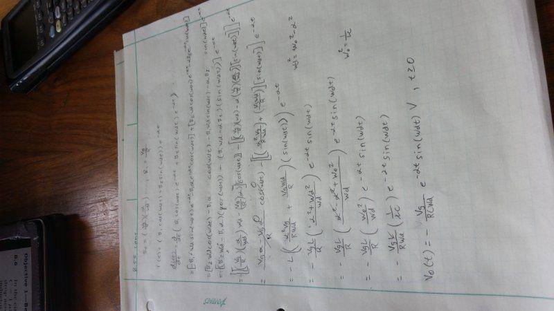

So I'd rather not type out the whole equation I am differentiating with respect to t... Sorry admins. My written work is on the image. I just want to make sure my work is correct.
The equation is a differential characteristic equation with cos and sin.
The attempt solution is on the image. Start at Line 1 to Line 2.
I applied product rule twice with chain rule. We are taking the derivative of the formula with respect to t.

From what I can see in that little thumbnail, it looks fine.
vela said:
From what I can see in that little thumbnail, it looks fine.[/QUOTE
Okay thanks. Does my simplifying look fine as well?
You simplified? It's hard to see anything in that little thumbnail, so I'll take your word for it. I suppose I could click on the thumbnail to bring up the larger image, but I'd rather not.
No .
sin(θ) + cos(θ) ≠ 1
However, sin2(θ) + cos2(θ) = 1, but you don't have that anywhere.
