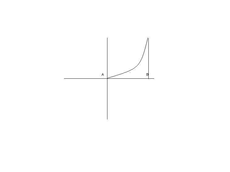

Point A moves uniformly with velocity v so that the vector v is continually "aimed" at point B which in its turn moves rectilinearly and uniformly ith velocity u <v. At the initial moment of time v is perpendicular to u and the points are separatd by distance k. How soon will the points meet?
Refer to diagram:
All that I could make out from the question was that the path followed by the Point A will be a parabola. And the angles between vectors will continually change, it will decrase to be specific.
A is assumed to be at the origin of the cartesian plane.
At any instance of time (t):
Velocity of A relative to B
V(X component)= v cos \vartheta
V(Y component)= v sin \vartheta-u
\vartheta is the angle which the velocity vector v makes with x axis. \vartheta changes with time.
Acceleration:
A(x)=-v sin \vartheta*(d\vartheta/dt)
A(y)=v cos \vartheta*(d\vartheta/dt)
magnitude of acceleration(as obtained from the above components)= v *(d\vartheta/dt)
=v \omega
\omegais the angular velocity.
Well, I haven't studied kinematics in very much details, not even circular motion. But I am able to solve simple questions on circular motion. I know simple usage of basic calculus. Please guide me to solve this, as its been a long time since i have been trying this question.

Yes, I know where point B is after time "t". It will travel "ut" in positive direction of x axis.
But how can tan θ be determined from that?:confused: Actually please tell me what do you mean by (x,y). What coordinates are these? I think tan θ at any instant t will vary:
The perpendicular would be distance traversed by B (ie, ut) in that time - the vertical distance covered by A in that duration.
Similarly base would be the remaining horizontal separation.
Now how can these things be determined?
θ is the angle made by vector v with x axis. Is it not?
Please help me. I am new to these things. And i really don't have enough patience to go one with just on problem. its simply infuriating... :) thanks for the help
Hi ritwik06! :smile:
(x,y) is the position of A … x along the x-axis, and y up the y-axis.
As you say, B is at position (k,ut).
So the vector AB is (k - x, ut - y), and so tanθ = (ut - y)/(k - x). :smile:

But u have added two more unknowns to my equation :smile:
Most probably I have to diffrentiate the equation obtained. right? If yes, with respct to what ?? There are 4 variables in the function x,y,θ,t...
how shall i proceed? Please help me dear. I don't really have any idea about this. I had tried my best and shown u the results.
And on more thing:
when the points meet ut=y
and k=x
therefore tan θ is undefined
Please do help me clearly tim. Do u want me to remain stuck with this?
You already have all the information you need to solve this.
You know that the magnitude of v is constant.
You know the direction of v as a function of x y and t.
So write out the differential equations, and solve them! :smile:

As u say, "v" is constant. But "v" is not involved in our equation for tan \theta. I tried to differentiate the equation in tan \theta with respect to time t:
I got this:
u=(sec^2 \theta) *\omega*(k-x)
There is still the angular velocity and x coordinate.
And please I would like to tell u one thing. I am in standard 11 only. I have not even learned calculus fully. Just some basic formulae.
Please will u help me with this through?
