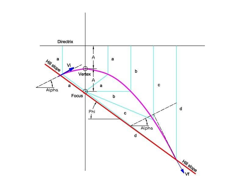

Note that the maximum range for horizontal surface is achieved at 45° for the Vi vector.
Please, see:
https://www.physicsclassroom.com/mmedia/vectors/mr.cfm
In the case of our hill, the maximum range is possible for the same angle of 45° for the Vi vector, but respect to the surface of the hill.
Therefore, Vi and Vf vectors should remain perpendicular to each other, regardless the value of the angle Phi.

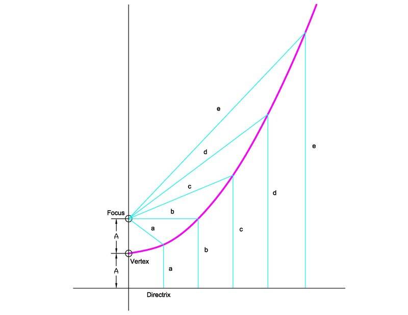

phantomvommand said:
The question does ask for the angle of launch so as to maximise range, so it is definitely relevant. But why is it that for the trajectory that gives maximum range, its velocity upon landing is along the angle bisector of the hill and the vertical to the directrix?
I believe it is clearly explained (for the horizontal land case) in the link in post #4 above.
Please, read it when you have time.
Adapting that concept for a vertical parabola to the hill (sloped surface), I have graphically shown in the diagram of the same post that vector Vi bisects a-a, as much as Vf does it to d-d.
Copied from that link:
"The range of a projectile is determined by two parameters - the initial value of the horizontal velocity component and the hang time of the projectile. As can be seen from the animation, the projectile launched at 60-degrees has the greatest hang time; yet its range is limited by the fact that the Vx is the smallest of all three angles. The projectile launched at 30-degrees has the greatest Vx of all three launch angles; yet its range is limited by the fact that the hang time is so short. The projectile launched at 45-degree does not win in either category, yet the fact that it is able to place a strong showing in each category contributes to its ability to achieve the greatest range."
Adapting that concept to the hill (sloped surface), I have graphically shown in the diagram of the same post that vector Vi bisects a-a, as much as Vf does it to d-d.
I do not agree with your claim that range is maximised when launched at 45 degrees to the hill. The result of the problem suggests that the ideal launch angle is ##45 + \frac {\phi} {2}## away from the hill.

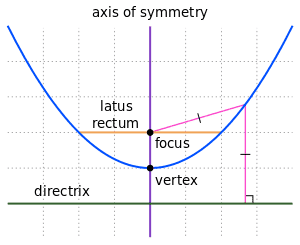

I have since worked out the solution to my own question, and have found that it is a mathematical feature of the parabola where every tangent bisects the angle formed by the vertical to the directrix and the line to the focus.
Your graph in #4 contains some errors too, I believe. The parabola mentioned in the solution represents the envelope of all possible trajectories, not the parabola of an individual trajectory. Furthermore, the focus (of the envelope of all trajectories) should be also be the launch point.
