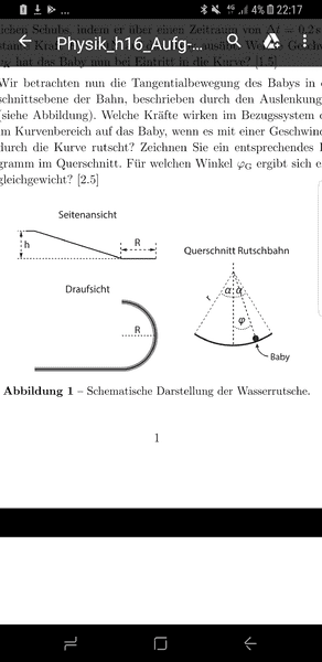

A person enters a curve of a waterslide with velocity v. The curve is fully horizontal and has the shape of a circle segment of radius R, there is no friction and width of the curve can be neglected for calculating the centripedal force. The waterslide itself can be described as a semi circle with radius r. The question is to describe the tangential equation of motion for the angle a the person in the slide. We must than linearise this equation of motion with the small angle approx for sin and cos.
