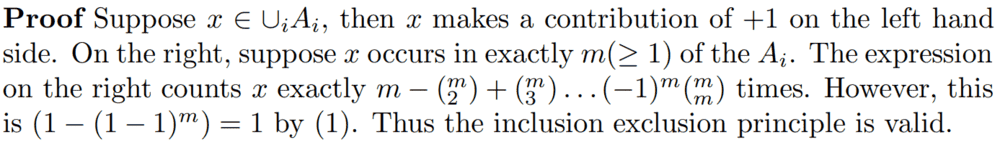

Typeset theorem statement: for finite sets A_1 through A_n, the cardinality of the union of A_i equals the sum of |A_i| minus the sum of |A_i1 ∩ A_i2| over pairs, plus the sum of triple intersections, continuing with alternating signs to (-1)^(n+1) times the cardinality of the intersection of all A_i.
Text proof of the inclusion-exclusion principle: for x in the union of the sets Ai, x contributes +1 on the left, and on the right it is counted m - C(m,2) + C(m,3) - ... + (-1)^m C(m,m) times, which equals 1 - (1-1)^m = 1.
This is a popular combinatorial proof for the Inclusion-Exclusion principle but I was wondering what kind of proof technique they use?
Initially I thought - since we have cardinalities on both sides of the equality , I thought we'd have to show a bijection exists between the set on the left side and the overall set on the right side, but this way is difficult here ( partly because it is not exactly clear what set the cardinalities on the right-hand side represent ).
Then I thought maybe we could use what's called " Combinatorial proof " ( which is essentially the same thing as building a bijection between both sides of the equation although not in a forward manner ) and for this I'd show how to calculate the number of elements on the left-hand side and the right-hand side and then show they're equivalent; but using this technique stumbles me again since a-priori we don't have an indication to what the number of elements on both sides of the equations might be or how to even calculate them.
Then I tried to think more about the proof above: what they are doing is to take an arbitrary element in ## \bigcup_{1 \leq i \leq n} A_i ## and show how many times it appears ( counts ) in the left-hand side and the right-hand side of the equation. But I don't exactly see how this proves that the equation above is valid since all they did prove is that x is counted the same on both sides of the equation. Also, What kind of proof technique they use? is the technique they use is a variant of " Combinatorial proof " ?

I feel like you're trying too hard to put a label on a proof, which doesn't feel healthy. Mostly I think this is combinatorial - writing down the sum of m choose ks is combinatorial. Expanding ##(1-1)^m## is just algebra, but a pretty clever application of it.

We can list all elements in the union ##\cup A_i =\{x_1,\ldots,x_k\}## and perform the argument on every single ##x_j##. This means we have a well-defined function ##f: |\cup A_i| \longrightarrow \mathbb{N}_0## from the number of elements in the union to a certain number of elements on the right. The proof shows ##f(|\{x\}|)=1##, and ##f(|\{\}|)=0## is obvious. Your question can now be phrased as: Why is
k=f(k)=f(|\{x_1,\ldots,x_k\}|) \stackrel{?}{=} \sum_j f(\{x_j\}) \stackrel{\text{proof}}{=} k\cdot 1=k
Hence the equalities on the far most left and far most right imply equality in the middle.
Edit: Maybe the left most requires an induction to be rigorous: ##f(n+1)=f(n)+1.##
I think it can be called counting. It counts twice and observes that the results are the same. It is a direct proof.

I think the key, and far easier than the approach in Q1 is actually to prove ##f(n+1)=f(n)+1## by induction. It means to examine what happens if we add one element to the union. The induction base is trivial: ##f(|\{x\}|)=f(1)=1=0+1=f(|\{\}|)+1.## Say ##\cup A_i=\{x_1,\ldots,x_n\}## and ##n## equals the right hand side of the function by induction hypothesis. We then consider ##A_{n+1}=\{x=x_{n+1}\}## with an additional element ##x\not\in\cup_{i=1}^nA_i .## All sums on the right have next to be considered, since they are one index longer now. However, ##A_{n+1}\cap A_i = \{\}## for all ##i\leq n##, hence only the first sum changes: ##\sum_{i=1}^{n+1}|A_i|=|A_{n+1}|+\sum_{i=1}^{n}|A_i|=1+\sum_{i=1}^{n}|A_i|## and with the unchanged other sums we formally get ##f(n+1)=f(n)+1.## Since ##f(1)=1, ## we have ##f(k)=k## for any ##k##.
This must be brought into some order and my clumsy argument should be written more carefully, but I think it contains all formal steps now. But it is really very formal.
