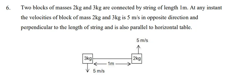

Two blocks of masses 2kg and 3kg are connected by string of length 1m. At any instant
the velocities of block of mass 2kg and 3kg is 5 m/s in opposite direction and
perpendicular to the length of string and is also parallel to horizontal table. find tension in the string. (image attached below)
mv^2/r = centripetal force
from the question i thought that the two blocks would be carrying out uniform circular motion about a on the string such that the centripetal force (tension) acting on each block would be equal:
$$ \frac{m_{1} v_{1}^{2}}{1 - x} = \frac{m_{2} v_{2}^{2}}{x} $$
and on solving for x (taking m1 as 3 and m2 as 2) got x=2/5
putting x back into
$$ \frac{m_{1} v_{1}^{2}}{1 - x}=T $$
i got tension as 125 Newton, but the correct answer is 120 Newton according to the answer key.

Those velocities are presumably relative to the table.
And "for any instant" suggests that this system of masses and string will remain on the table with those same velocities. It is in contrast to "at one instant". But that cannot happen without some external force acting on the system. The question does not suggest how that force acts. Is one of the two masses being held to an 5m/s orbit that allows the other to orbit freely a 5m/s - effectively making the system work as one with two equal masses? If so, is it acting as two equal masses of 2kg or 3kg - or is the force split between them to act as a 2.5kg+2.5kg system?

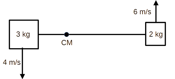

The system's centre of mass (CoM) has some velocity. If you find this and transform the velocities to the CoM frame, the figures are then consistent with uniform circular motion about the centre of mass.
This gives a tension of 120 N, as required.

It's not an assumption. Using the Post #1 diagram we see that the momentum of the 3 kg mass is 15 kgm/s in the -y direction and the momentum of the 2 kg mass is 10 kgm/s in the +y direction.
It’s natural (and IMO convenient) to move into the CoM frame. Then only simple calculations are needed to:
a) check that the 2 angular speeds about the CoM are the same (i.e. do a consistency-check on the data);
b) find the tension.

Yes. The system described consists of 2 masses connected by a string with no net external forces. So the CM has a constant velocity of ##-1~(\text{m/s})~\mathbf{\hat y}##.
BTW I'm assuming the original question is badly worded so that:
"At any instant the velocities [are 5 m/s in opposite directions]”
should be:
"At some instant the velocities [are 5 m/s in opposite directions]”
The speeds could not remain equal - otherwise the system, as described, would be behaving unphysically.
We have a binary system - uniform circular motion with unequal masses orbiting their CM. In the CM frame:
If the system is also translating at 1 m/s in the -y direction, then the speeds (at the instant depicted) are both 5 m/s, corresponding to the original question.

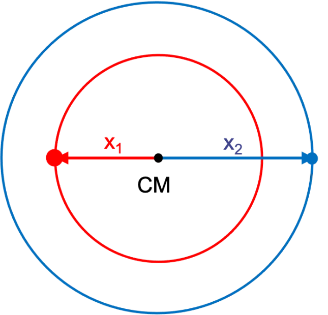

The real problem with wording is in the statement of the question. The masses cannot be unequal and have equal speeds in opposite directions. An observer at rest with respect to one mass sees the other mass orbit around him with some frequency ##\omega##. The same can be said about an observer at rest with respect to the other mass. From the standpoint of an inertial frame, the two masses orbit about the center of mass as shown in the figure on the right. It's like a binary system of two stars of unequal masses with tension in the string replacing the gravitational force.
The blue mass is smaller and farther away from the CM than the red mass. The condition that says this is the definition of the CM, in this case ##m_1x_1=m_2 x_2.## Now the orbital speed of each mass about the CM is given by ##v=\omega x.## If you multiply both sides of the condition equation by ##\omega##, you get $$m_1 \omega x_1=m_2 \omega x_2 \implies m_1v_1=m_2 v_2.$$ Since the velocities associated with these speeds are in opposite directions, this says that the total momentum of the binary system is zero, therefore the CM does not move. It also says that the speeds cannot be equal unless the masses are equal in which case the blue and red orbits coincide.
The figure that comes with the problem is misleading but not hopelessly wrong. If one solves the problem from the standpoint of an observer in the non-inertial frame of one of the masses, the answer comes out to be 120 N as reported by the OP.
