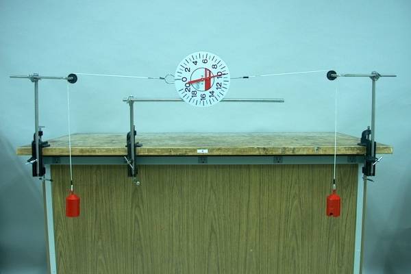

Both these masses are of 1kg each and the scale reads in Newtons.
The intuitive answer for the reading of the scale is about 20N because it is being pulled by 10N from each side.
However, this is clearly not true as the scale reads about 10N. Why is it so?
I believe that I am misled by thinking of action reaction pairs working on one body.
Looking at just one of the masses, the downward pull of gravity must be balanced by the tension of the string above it since the mass is not moving. Since there is 10N of force pulling the mass down there must also be 10N of force from the string pulling it upward. Thus the tension in the string is 10N.

I have got it now. The spring balance will measure the tension in the string no matter what the weights are. Even if one of the weight is removed and the string is tied to a pole the tension will be same. The spring balance will still read about 10N. Actually, I was confused that a force of 10N is acting on each end of the spring balance. Then I thought what happens when we use a spring balance normally(i.e. vertically), even then there is a force of 10N on both ends of the balance but only the downward force of 10N on the bottom part of the spring can cause expansion and hence the balance shows 10N.

Yes, and as long as the two weights on either side are equal and there is no acceleration of the masses, the tension will be equal to one of the weights.

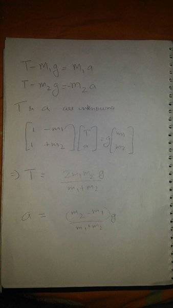

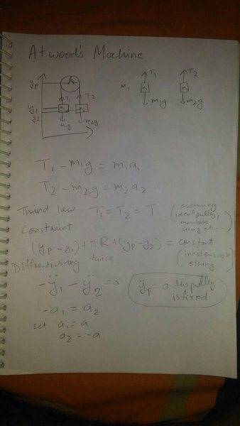

The system is an Atwood's machine and unequal masses produce acceleration. Check the attachments to see how I worked out the Atwood's machine.
So T will be as derived in the attachments.

Correct. Note that your expression for T gives T = mg when the masses are equal, m1 = m2 = m.
