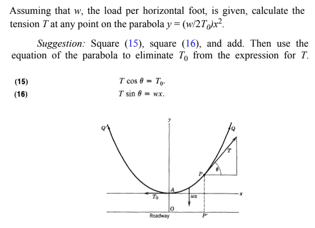

Assuming that w, the load per horizontal foot, it given, calculate the tension T
See (15,16) below

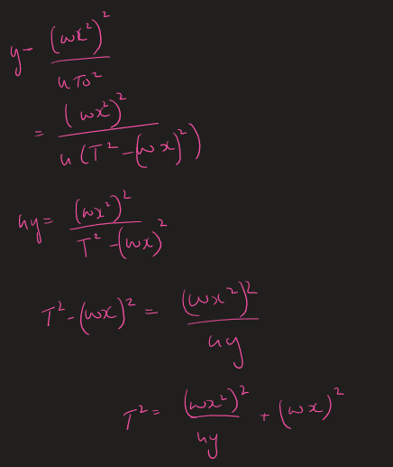

I am unsure how to go about this. I tried following the suggestion blindly and end up with with some cumbersome terms that are not the answer. From what I understand the derivative at each point would equal to T?

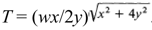

Answer:
I just can seem to get to this. I think I'm there but can't get it in this form

Answer: View attachment 262706 I just can seem to get to this. I think I'm there but can't get it in this form
Right at the start you have y on the left instead of y2. Correct that and you should get the target answer.
What's wrong with their suggestion? I assume you got ##T^2 = T_0^2 + w^2 x^2##, and along with ##y =\frac{w}{2T_0} x^2##. That should be sufficient to find ##T## in terms of ##x##, ##y## and ##w##.
Yikes! YES, thanks for the catch! I was so frustrated trying to solve this one.
