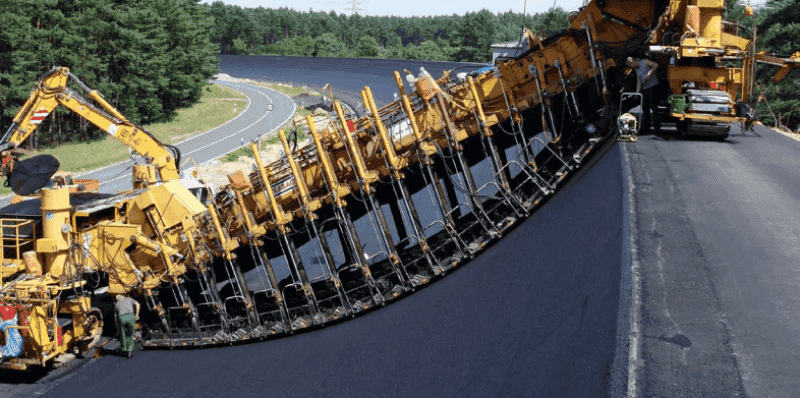

Harshit puri
Why test tracks are banked parabolic why not elliptical or circular or hyperbolic? what are advantages of parabolic curve over another curves?

Thanx Mike..i agree with ur point as varying angle with the curve will help to counteract the centrifugal forces which vary with changing speeds.. but why specifically parabola why not ellipse or hyperbola, what will be in case of ellipse or hyperbola.. i need some geometrical reason to support why we choose this curve.

thank you mike. yeah i might be wrong ! and always get confuse between two but can you refer some book or reading material which will give m a more broad idea about same and i am very specifically talking about banking.. it would be great if u provide any study material for designing track if u know one.

i want a mathematical reason why a parabola profile is used in super elevation of testtrack like bloss curve or clothoid geometry or whichever curve it takes by profile i mean u have a side view of path the angle changes with change in distance, whichever equation we choose what is the reason, let's say if eccentricity contributes to it then how eccentricity of circle 0 makes it perfect or is the reason for not chosing it or how eccentricity of parabola is 1 which is good for it. (i'm giving an assumption of curve property which might be wrong or btr say i don't have idea.)

Nuetral banking angle is the key phrase.
If you want to travel a bend at speed with a minimum or no sideways slipping (drifting) forces, you calculate the banking angle to suit, if you want it to suit a range of speeds on one corner you end up with various banking angles added end to end or, if your really cool you could create an exponential or parobolic which gives you infinite variation over the cornering speed range.
Have a look at the data sheet for nailing the nuetral angle:
ive added the excel sheet, try a few different speeds.
