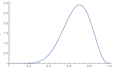

@Dale a question on Bayes' theorem. If my prior probability that the coin is biased = 0.7, can the probability of heads = 0.5? I need the probability of heads to compute P(k heads | coin is biased) = P(evidence|hypothesis). Also I feel that P(coin is biased) = P(heads for a head-biased coin) = 0.7. Wrong?
Remember that the prior probability specifies your uncertainty. That is the probability density for all frequencies ##F##, not just one.
So, for example, if you had some good prior reason to suspect that the coin is biased towards heads you might specify that your prior is ##F\sim \beta(8,4)##. That would mean that you think it is about 50% chance that ##0.60<F<0.79##, but you also allow a 50% chance that it is outside this range.

Thank you. I do understand a bit of the ROPE (region of practical equivalence) trick :smile: you mentioned. For this particular case (biased coin hypothesis), the ROPE is a range e.g. [0.45, 0.55] for the proportion of heads you would consider to be an outcome for a fair coin. It seems there's a probability associated with this range (is this the ##\beta## distribution?). Now we conduct an experiment and say the proportion of heads = ##p##. Either ##p## will be inside the range [0.45, 0.55] or outside it. If the former, then we conclude the coin is fair (the proper expression would be the coin is "practically equivalent" to a fair coin?) and if the latter we conclude the coin is biased.
For B: the coin is biased, E: the proportion of heads ##p## (see above)
##P(B|E) = \frac{P(B) \times P(E|B)}{P(E)}##
For ##P(E|B)##, we look at the ##\beta## distribution, yes? Is ##p## inside/outside the range [0.45, 0.55]?
For ##P(E)##, we also need to know ##P(\neg B) \times P(E|\neg B)##. I don't know how to do that?

Agent Smith said:
It seems there's a probability associated with this range (is this the β distribution?).
Yes. This would be the prior probability ##P(H)##. If your prior probability is a ##\beta## distribution then yes you would use that distribution for the calculation. Whatever distribution you use you would integrate or sum the distribution over the ROPE (e.g. [0.45, 0.55]) to get the prior probability that the coin is fair.
In the excel spreadsheet you can just literally do SUM over the rows from 0.45 to 0.55 in the P(H) column (the prior).

I think there might be a bit of confusion on what probabilities are what. It is a little confusing because there are two kinds of probabilities in this problem.
One probability is the probability that the coin shows heads. This is the usual frequentist probability, so we could call it the coin frequency. In principle, this is a property of the coin itself, based on its physical characteristics and the physical way that it is flipped.
The other probability is what we use to represent our uncertainty about the frequency. This is a Bayesian probability. In is not a property of the coin, but a property of us, based on our uncertainty and our limited knowledge about the coin.
To avoid confusion, from here on I will use "frequency" to refer to the probability of the coin landing heads and "uncertainty" to refer to the probability that represents our limited knowledge. Please be aware that both are completely valid probabilities, but they are different things.
In the excel spreadsheet I sent, ##H## is the frequency, and ##P(H)## is the uncertainty. ##P(H)## is a probability distribution of our uncertainty over all possible frequencies. So it does not just have a single value, it as a value for every possible value of ##H##.
The statement "the coin is biased" means that ##H## is not in the ROPE. So "the probability that the coin is biased" is ##P(\neg (H \ \in \ ROPE))=1-P(H \ \in \ ROPE)##.
Agent Smith said:
D = The data/evidence (70 heads in 100 flips)
P(H) = 0.5 (prior probability)
So here, ##P(H)## is a probability distribution of our uncertainty at every possible frequency. It is not a single value, but rather it is a function of ##H##. This means, to describe something where we have a 50% probability that the coin is biased means that we want to use a function ##P(H)## such that the sum of all ##P(H \ \in \ ROPE)=0.5##.
I have updated the spreadsheet and placed such a function as an example in column B. Of course, you may not like that the function has a dramatic step going from in the ROPE to out of it, but that is why I like the beta distribution for this purpose.

You essentially used Baye's theorem once, based on treating ##P(H)## as a single value. What you want to do is evaluate Baye's theorem for every possible frequency. So you use it once for each value of ##H##. That is what is calculated in column F in the spreadsheet.
Notice that with 70 heads and 30 tails, even though we started with a prior uncertainty that the coin was 50% likely to be fair, in the end the data has convinced us that there is only a 1.3% chance that the coin is fair. The data has dramatically changed our uncertainty about the fairness of the coin.
