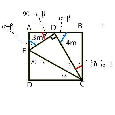

I need to find the area of the square in the following figure:
Square ABCD with a right triangle inside: vertices E on side AD, D on top edge, C at bottom right; segment DE labeled 3m, segment DC labeled 4m, right angle at D, and segment EC drawn.
Basic Trig relations.
I aimed to find the length of BC, but first I had to find the unknowns of the right triangle CDE, which are EC=5m, <DCE=36.86ْ , <DEC=53.13ْ .
Then I thought that I can use some trig relation for angles to get <BDC and BCD respectively (since the angles of the square are all 90ْ).
And that's where I am stuck. Any help?

The upper two right triangles AED and BDC are similar. Look at the angles.
Geometry diagram of a square ABCD with points E on side AD and D on the top side, a right triangle with a right-angle mark, segments labelled 3m and 4m, and angles labelled alpha, beta, 90-alpha-beta and alpha+beta.
Call BC = s, DB = y, and AD = s-y. It's easy to get two equations in s and y.
I got it now. Thank you everyone for your help. I really appreciate it.
