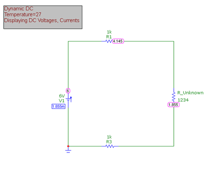

The following circuit has been modeled using some modelling software (Micro-Cap 11).
I was wondering why current is only shown at the source and not in R1, R_Unknown and R3.
I know current is meant to be the same in series although I am confused by the effects of the resistors.
(This is not a homework question, just pure curiosity.)

Why are you confused? Seems like you already know the answer.
Yes, the current is the same everywhere in this circuit, so it makes sense to show it only once.
For the other numbers shown, it seems to be like this:
R_total = R1 + R_unknown + R3
U = 6V
I = 1.855 mA
Voltage drop over R1, measured across R1: U_R1 = R1 * I = 1.855 V
So, measuring the voltage after R1 to ground would give you U - U_R1 = 4.145 V
The voltage drop of R3 is the same, so also 1.855 V.
And for R_unknown it should be:
U_R_unknown = U - U_R1 - U_R3 = 2.29 V
(Since all voltage drops together should sum up to the total voltage of the battery... Kirchhoff's Voltage Law.)
R_total = U / I = ~3234.5 Ohm
U = R_total * I
U = ( R1 + R_unknown + R3 ) * I
Solving this for R_unknown:
R_unknown = U / I - R1 - R3 = R_total - R1 - R3 = ~1234.5 Ohm
The voltage drop of R_unknown seems to be right:
U_R_unknown = R_unknown * I = 2.29 V
The sum of all voltage drops in series should give you the total voltage again (check 2.29 V + 2 * 1.855 V = 6 V).
So the number shown after R_unknown (1.855 V with the pink frame) should be the voltage measured across R3...

So the current in R_Unknown will be the same. I would have thought the resistor would of restricted the flow of current so in the resistor current would be less?
No, the current is same in all resistors in serises. This follows from the law of conservation of electric charges.
Ok thank you. So why do voltage drops change then.
Ohm's law?
The voltage drop is due to the energy dissipated as the charges pass through the component. All such circuits settle down into the condition that the Power dissipated in all the resistors (given by IR) is equal to the Power input from the Source. That's the Conservation of Energy thing (Kirchoff's Second Law). The Charge conservation law is his first law.
I suggest you Google Kirchoff's Laws and read all about them. There is bound to be something at an appropriate level which will allow you to grasp what's going on. Remember - nothing 'knows what's going on' in a circuit; every element in the circuit just responds to the conditions immediately around it - so the 'sharing out' of Voltage is something that actually takes time and that time is governed, basically, by the speed of the initial electrical impulse round the circuit as the switch is turned on (a bit less than the speed of light).
